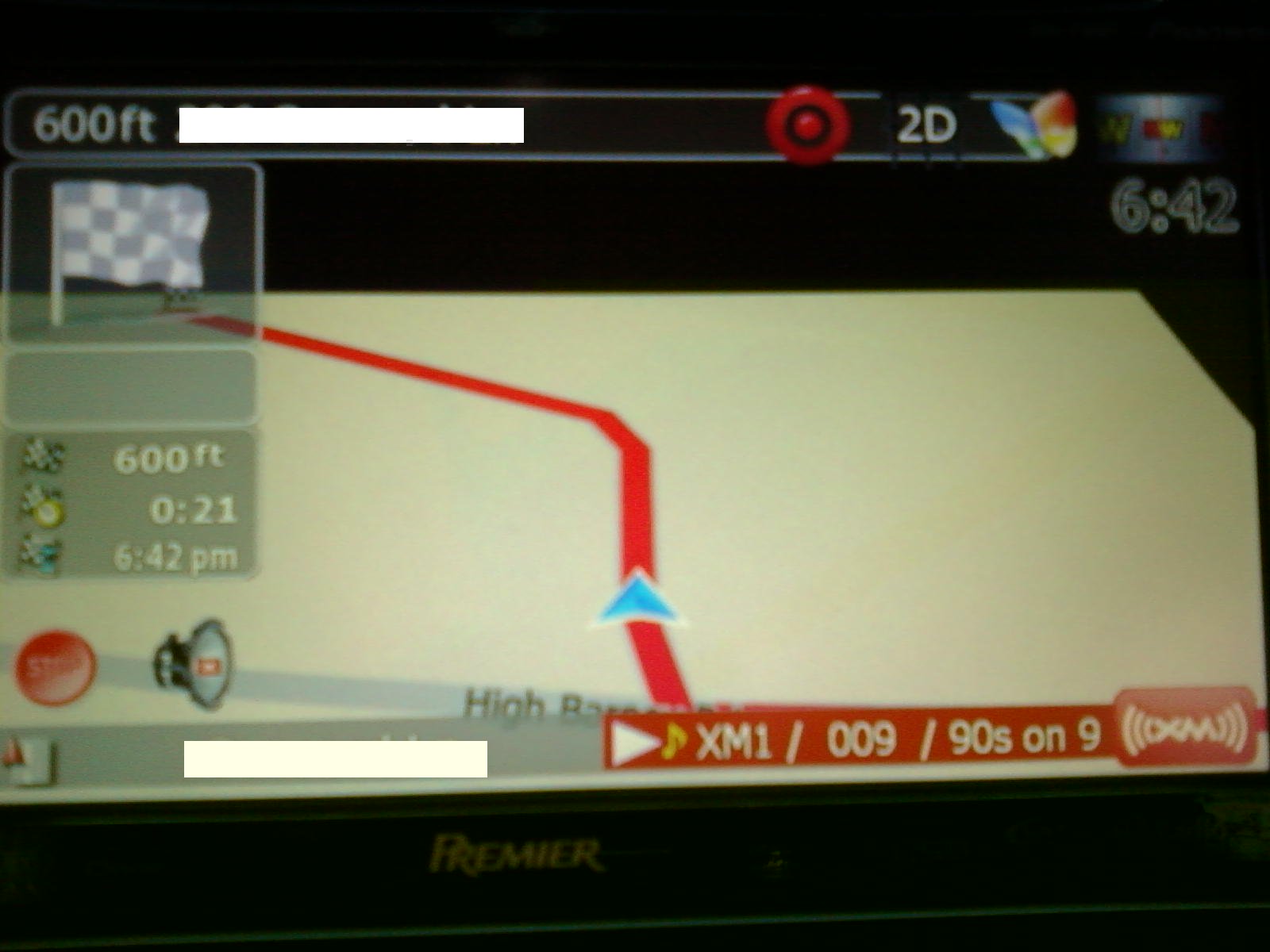

Hi everyone,
Just would like to find out how could I change the colour of the main route in my navi screen from green to something else?
Also the clock -font and color if possible.
And last can I change the direction arrows that appear in the top left corner with the distance to the next turn etc. from green to different color or even make my own ones?
Just not sure if its all to do with .bmp files or scripts.
Cheers for any help/info,
stm
Posted Jul 03, 2009 · 16:58 UTC#2
look for this code in your navigatemap_800_480.ui
and change color and color2 values to a hexcolor of your liking
for the direction icons, you have to edit diriconbig.bmp in common folder,

i think that's controlled by the color scheme
Posted Jul 04, 2009 · 13:18 UTC#5
not sure about the main navi route color but when you are in route, when the road is highlighted, that is the planned route line of the color.ini file in the scheme you are using. make sure you change it in the day scheme and night scheme. i used the color hex tool. i only changed the color not the ref values. good luck. i used the real day stormy and real night.
Posted Jul 06, 2009 · 15:33 UTC#6
Thats it JLEA, where abouts is the color.ini file or more info would be great:). Sorry to be pain lads just want to do it right :D
Cheers,
Stan
Posted Jul 06, 2009 · 23:19 UTC#7
hey stan
just go into the scheme folder, you should then see different zip files, click on one to open it and then in there are the color.ini files. just change the colors to what you want and save it. i pulled the color.ini file to my desktop then edited saved and replaced it right in the zip file, no extracting necessary, and it works fine. good luck
Posted Jul 07, 2009 · 16:26 UTC#8
JLEA I found the shemes folder and inside it I have Pioneer blue day, Pioneer blue night, Pioneer red day, Pioneer red night.
This is the content of the Pioneer blue day color.ini file that was zipped in it:

Could you please point out to me which values I should change to make it black for example? I wouldnt have a clue where to even start on that :lol::oops:
Also do I have to change all Pioneer blue day, Pioneer blue night, Pioneer red day, Pioneer red night?
Cheers and sorry for being a pain 8)
Posted Jul 08, 2009 · 14:33 UTC#9
http://www.colorschemer.com/online.html hey stan this is the link to the hex editor. i don't know if i attached it right so just copy and paste if i didn't. the color code for black is 0,0,0. so here is what to do, do this in all the scheme color.ini and if they have color3d.ini also
look for this section:
; Label Colors
label_road = "", 0,0,0
label_roadlt = "", 90,90,90
label_settlements = "", 0,0,0
;oneway_arrow = "",112,112,204
oneway_arrow = "",64,96,204
oneway_arrow_ext = "",0,0,0
alpha_arrow = 5
;planned_road = "",0,255,0 ****change number only to 0,0,0 on this line only****
;planned_road_ext = "",255,255,255
;planned_road = "",104,240,104
;planned_road_ext = "",64,184,64
planned_road = "",64,240,64
;planned_road_visited = "",200,72,26
;planned_road_visited_ext = "",100,36,13
planned_road_visited = "",32,104,32
planned_road_visited_ext = "",8,96,8
;planned_road_future = "",208,64,9
;planned_road_future_ext = "",120,45,16
if you want something different then use the hex tool and play around with the colors this is all i did and it worked so good luck! don't remove any comma's or quote marks because i am not sure what they do...numbers only!!!! k
Posted Jul 08, 2009 · 21:15 UTC#10
Nice one dude, tested night mode and so far it works 8)
Cheers :D
