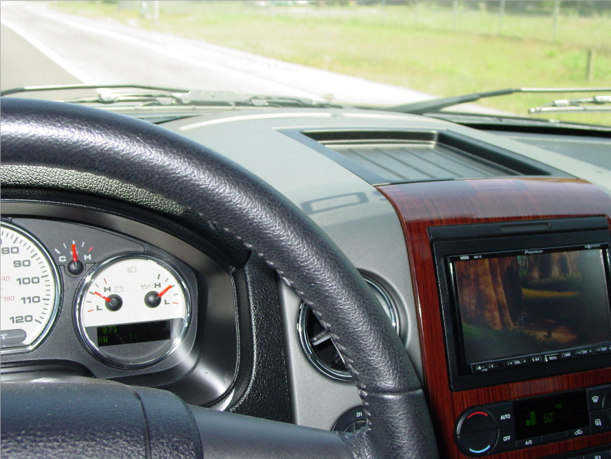

Posted May 13, 2006 · 17:54 UTC#3
It will work I have a '05 F150 Lariat Supercrew and the light switch trick works. Also, I did not cover a light sensor. I was out when the sun was its brightest and it worked. Look at the picture the I will post with this reply. Sorry that it is big, but I just did it a couple of minutes while my kids were watching HoodWinked in the rear. Sorry I could not get the actual speed I was going. It was kind of hard to get a good picture while driving...lol
