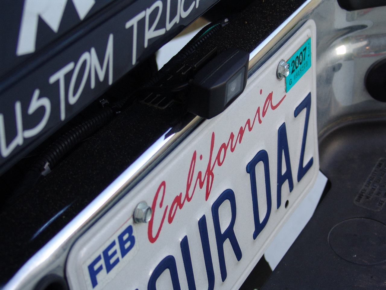

Thanks for the information. When you mean in the middle of the bumper do you mean that you put the mounting bracket behind the license plate or right above it so the camera would fold down? I am just trying to picture this in my head, thanks.
Posted May 16, 2006 · 14:15 UTC#4
Here's a pic.
Posted May 16, 2006 · 14:17 UTC#5
That is real nice!
Posted May 16, 2006 · 15:49 UTC#6
Thanks bro that is just what I needed.
