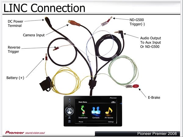

Figure it out myself, so put it out to share.
1. The brake line go to the ground or the frame of the car. Even you can run the setup by detaching the unit, it is still necessary to connect the brake line to the ground to form a complete electrical circuit. 2. The reverse signal wire goes to the the wire of the backup light which lights up when you put in the reserve gear, the f500bt comes with a 5 meter long wire for that purpose. That is for camera installation, if not, leave it alone. 3. The amp wire goes to the Pioneer ND-G500. it will mute the radio when there is incoming phone call as well as the GPS is voicing. When you hardwired the f500bt, it really means you need to go with Pioneer ND-G500(Amazone, $20, new including shipping). If you do not need the mute function, then you can leave it alone, 4. The battery line goes to constant 12V positive, it comes with fuse, it is for north America model only. 5. The DC power terminal line with a female plug goes to cigarette power 5V transformer which comes with the kit. 6. Audio output male plug is just for audio output, otherwise, let it out. 7. Not a good idea to use the suction cup to hold the unit unless you have the base touch the dash board, it will fallout when you drive. So I just place the unit just in front of the shift stick. It really need to be creative to stable the unit and still keeping the cosmetic neatness of the car interior. Poor GPS reception can happen when you put the unit too down in the car, using antenna comes with f500bt will overcome that.
Posted Aug 29, 2009 · 15:30 UTC#3
Here are the photo of harness wires and the connection diagram
F500BTConnection.pdf

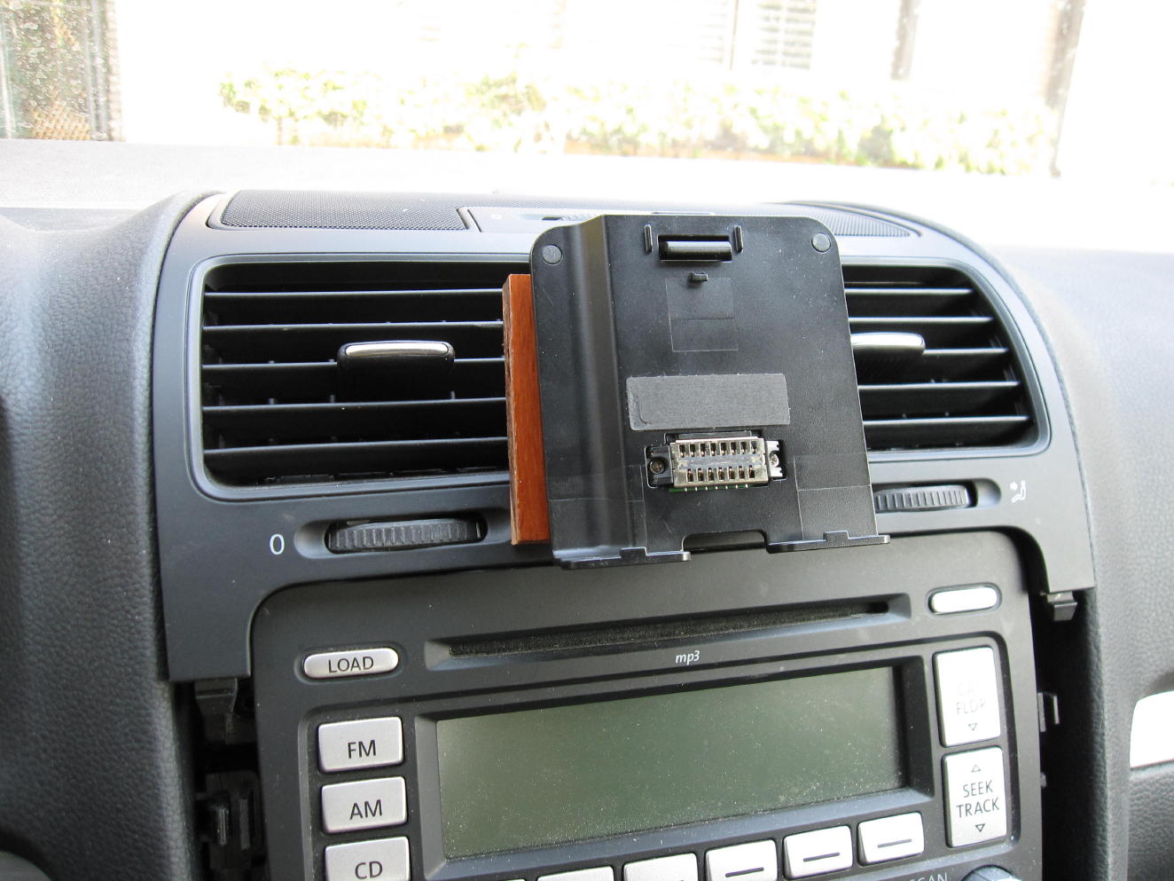

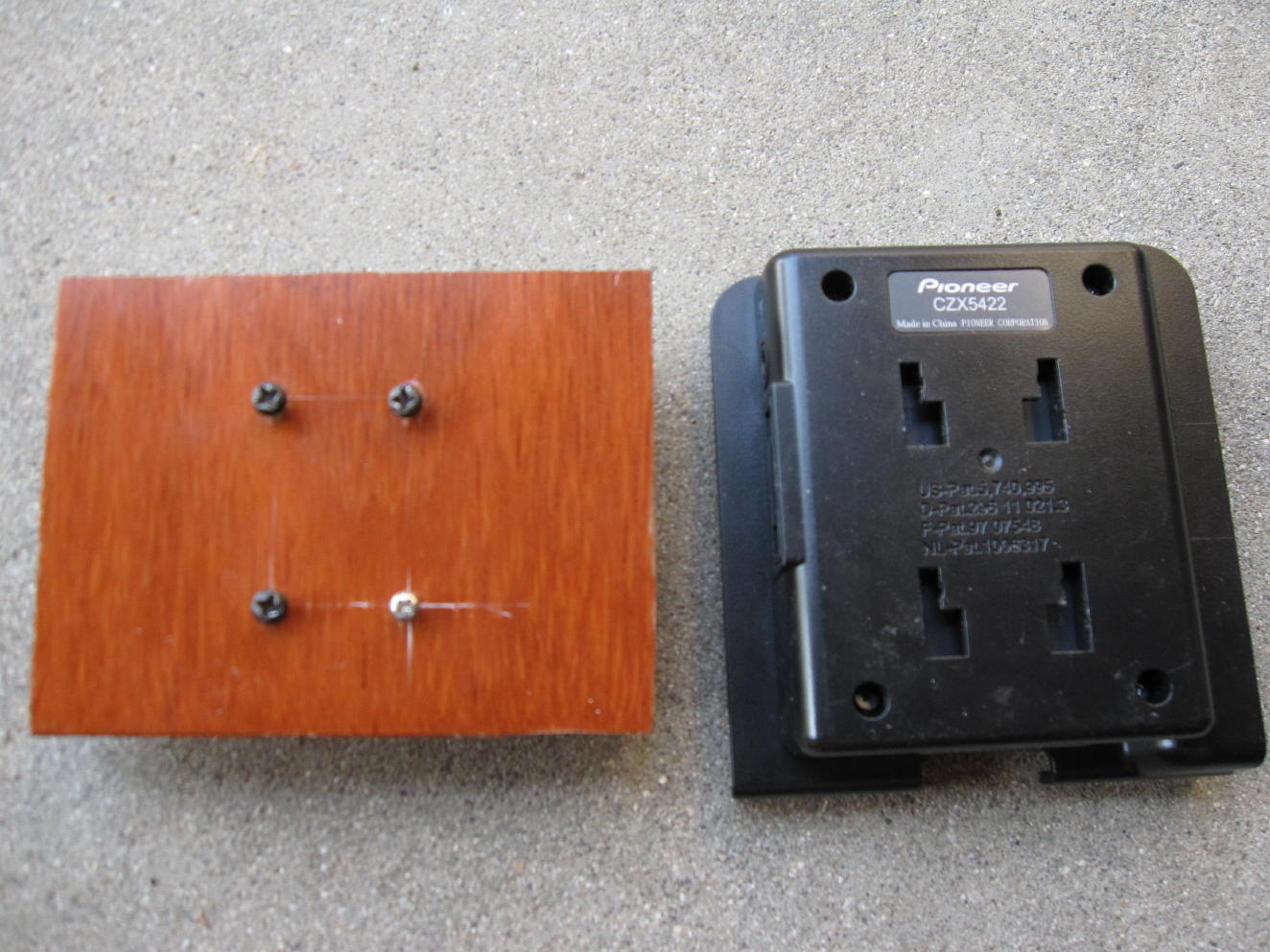

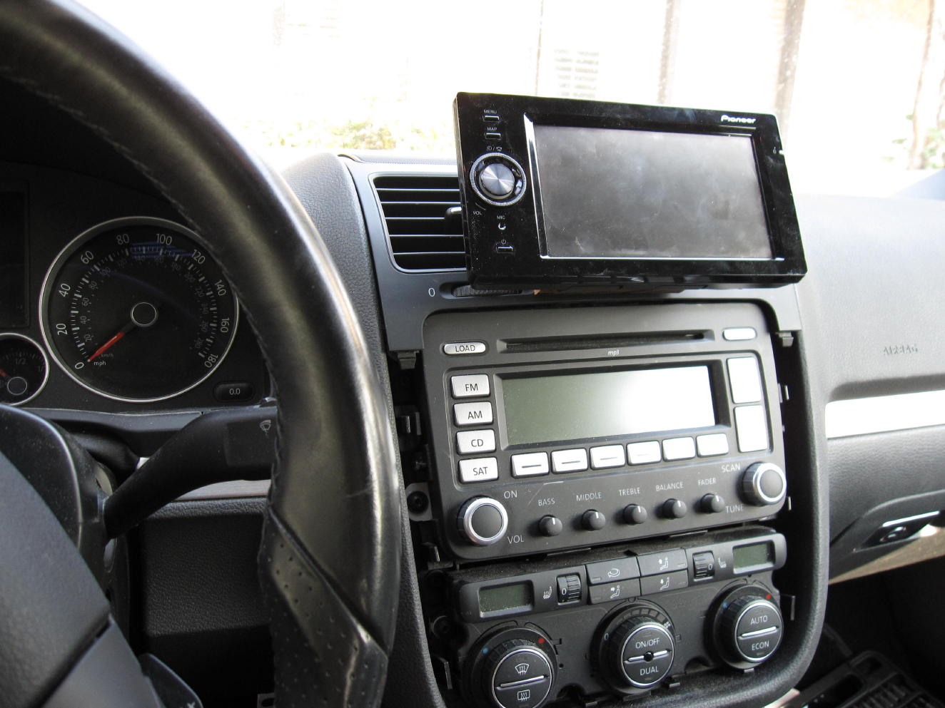

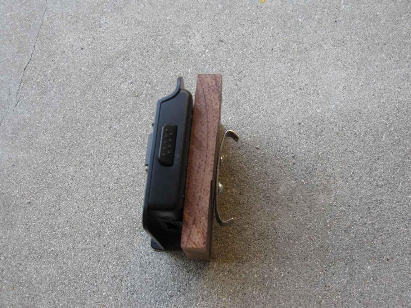

Posted Aug 30, 2009 · 19:26 UTC#4
I put the unit in the area in front of the shift stick, but it turn out to be a bad idea. When play with it while you are driving, one needs to move your straight forward eye sight downward, that is hazardous. So it needs to be moved up. So I did this.
1. Use a 2.5x3.5 inches hard wood floor piece(red hard wood), put 4 small screws approximated the four holes of the f500bt holder. 2. On the back of the wood , secured a rigid metal strip(I used copper), the two free ends of the metal strip were band like so it snap the edge of center vend of the console. snap the wood piece front the unit holder, then snap the back of the wood to the two edge of the center vend. 3. Put the Unit into the holder, the GPS reception is good that no need to use a external antenna. 4. I am told the portable GPS is a traction for crime, so I would removed the unit from the holder and put it into the glove box after parking in the public area.
