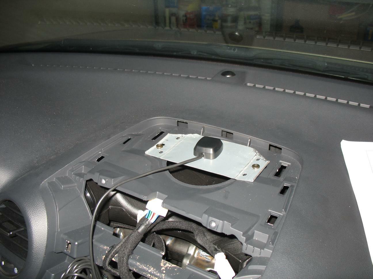

But I installed it little differently than whodat90 who another member installed F series on his Kia Rondo. I installed the antenna on the dash itself, but under the center speaker plastic cover( I do not have center speaker).
I did some tests before finalizing that location. I installed it temporary on roof, tried it, put plastic cover over it( the center speaker cover) and tried it. There is no difference in signal strength. Then I tried on dash with and without plastic speaker cover. Overall there is very minute difference between installing on roof vs installing on dash under the speaker cover, which is hidden, no need to run long cable etc.
But the problem with installing there is, there is hole in the center for speaker. I could not stick that metal antenna base sticker in proper place, so I made a small metal(steel, no aluminium) bridge over that. This way I do not need to make any holes to bring antenna out.
Since this is metal, no need for that sticker they provided to stick antenna on.

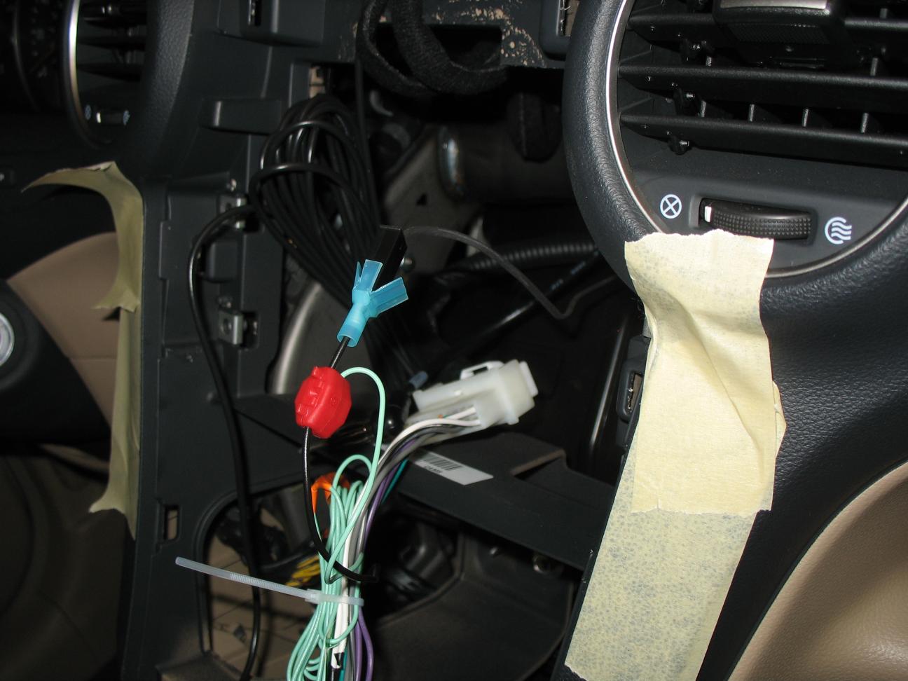

I was able to bundle up all the wire without touching any other wires and just kept the required length.
I got remaining Kit from Crutchfield, the Wiring harness, and Metra Double Din Dash kit. Initially thought of crimping the connections, but I saw several websites recommending soldering for good long term connections. I also saw the advantage of not having all the butt connector hanging behind radio(potential for noises). So, I soldered and taped individual wires, then bundled each set, then bundled all of those with zip ties.
For proper grounding I also used the grounding connector provided by KIA for the factory radio. This way body ground and actual radio circuit ground levelled or matched. Also, I grounding the parking brake connector so that I can use keypad, and enter the destination without pulling the handbrake. I have not seen any issues with this approach yet.
I was able to route USB, MIC, Aux cable independently so that other power cables do not cause any interference. All are tied to body with zip ties so they do not hang and make noise, and also can not be pulled from behind the radio accidentally.
