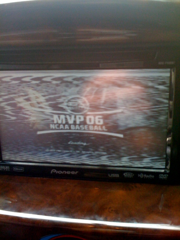

is there a mod to fix this?
By jacobpritchett · Oct 24, 2009in Hacks/Mods💬 13 posts👁️ 1,704 views
Posted Oct 24, 2009 · 20:16 UTC#1
Any ideas on what to do to fix this? I have searched quite a bit. If i have overlooked something chastise me briefly then point me in the right direction :) cheers
Posted Oct 24, 2009 · 20:21 UTC#2

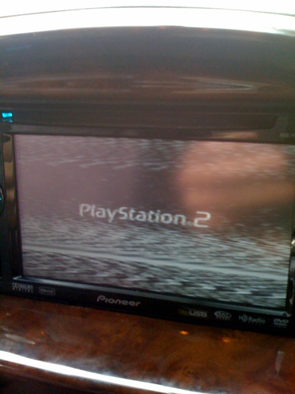

I was using my ps3, using the AV1 slot in the back of the headunit. I thought the cables weren't plugged in earlier when i tried with my N64 so i went and bought and extension and it didnt work. So i bought another extension with couplers to make sure they were real snug together and i still got that. SO i thought it might be my inverter so i plugged the ps2 up using a drop cord. and it STILL did the same thing. Please tell me what i am doing wrong.
Posted Oct 25, 2009 · 03:08 UTC#3
Im having the same problem here when plugging in any source to the AV1 in the back
Posted Oct 26, 2009 · 18:16 UTC#4
alright good, i am glad that i am not the only one having this problem. Anyone have a solution?
Posted Oct 26, 2009 · 22:34 UTC#5
what happens if you feed video from an ipod or iphone? I bet it works fine.
I say that because this is frequently a side effect of poor quality AC inverters and ground loops between components.
Posted Oct 26, 2009 · 22:39 UTC#6
Well i tried plugging the ps2 up with a drop cord and it still worked like that.
Posted Oct 27, 2009 · 01:01 UTC#7
yes, and if you have ground loop or AC isolation issues you'll still have them, that's why I suggested an ipod or iphone.
If you would prefer to ignore advice given, then feel free, the goal is to get you OFF of the AC powered devices to test the AVIC itself.
Heck, just try a battery powered DVD player, take the damn game consoles out of the loop for troubleshooting the AVIC itself!
