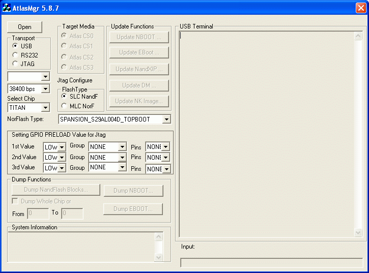

awesome carver you found it! I see where it says nand dump! have you tried it yet? maybe one step closer to larger flashdisks in the avics!
i try connect older AtlasMgr via USB to F90BT (need hardware switch)
but DUMP NAND button disabled. i try ENABLE this button, but also no any dump.
so, i tnink for NAND DUMP need JTAG connections or Uboot support with this functions.
In order to have those buttons activated via USB, you need a special cable designed for atlasmgr. It has some device close to the mini-usb end, aspect is similar to the noise filters on power or VGA cables. Don't ask me from where to get such a cable because I would like one, too ![]()
