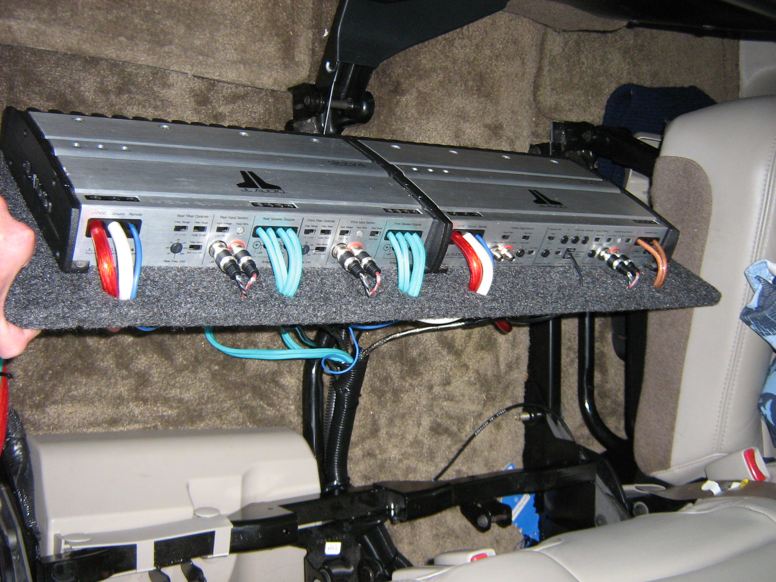

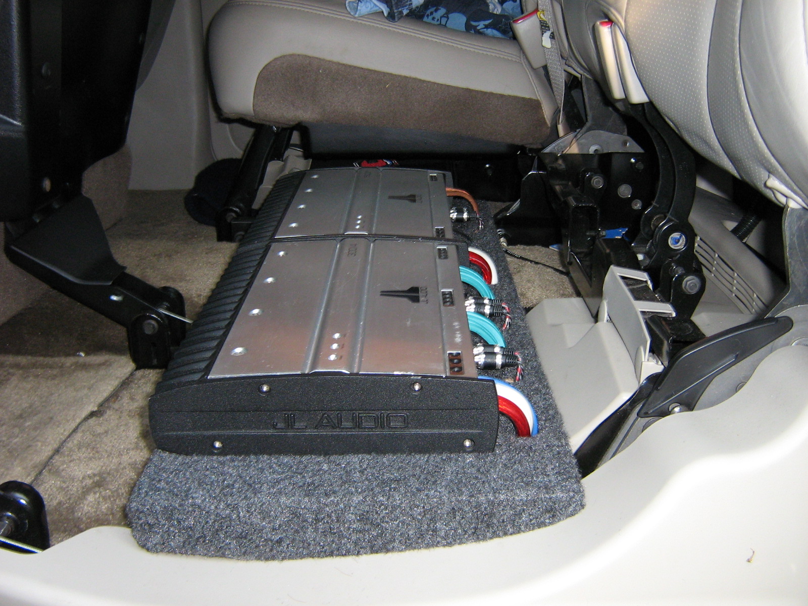

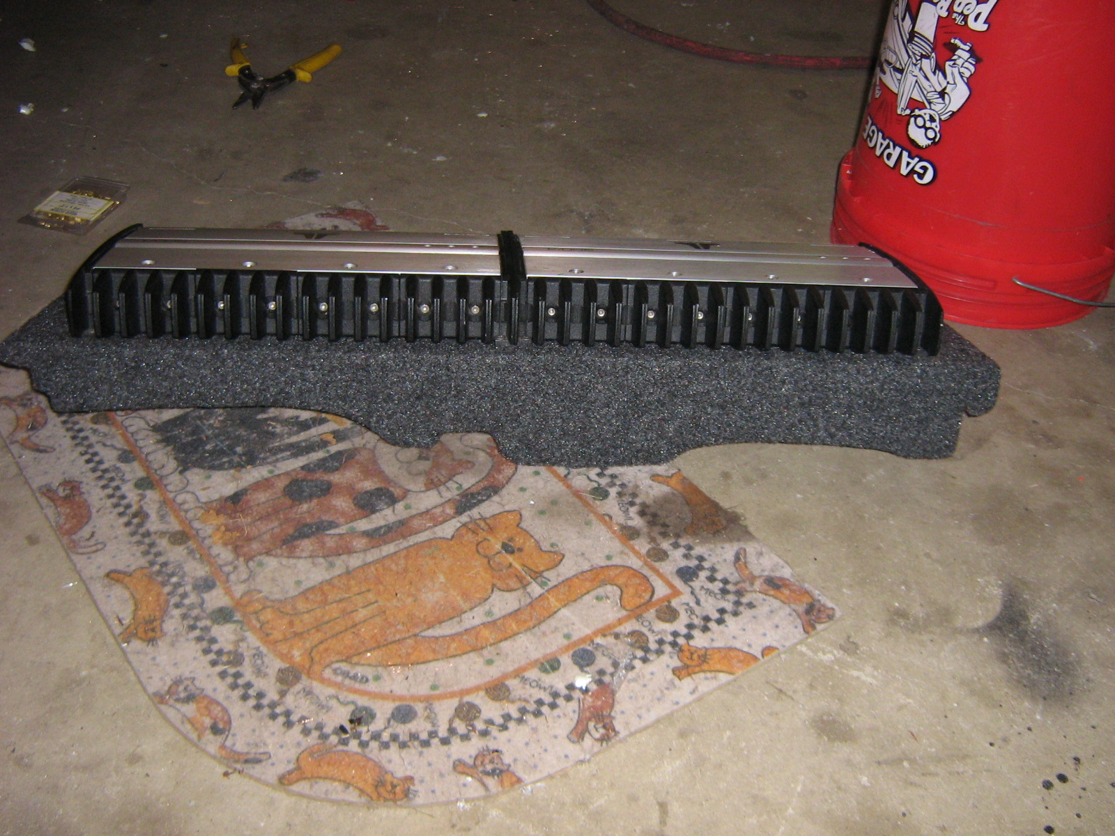

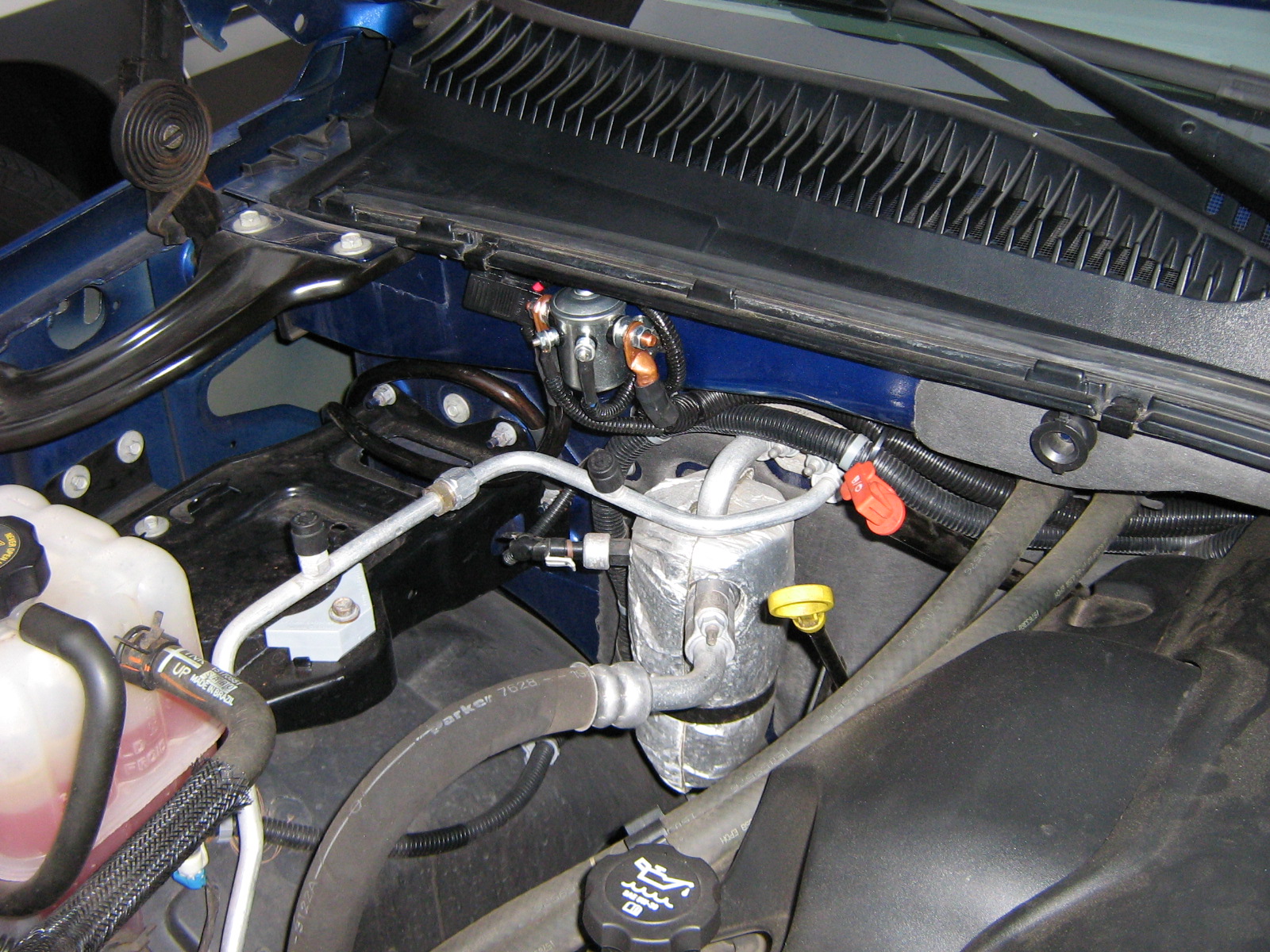

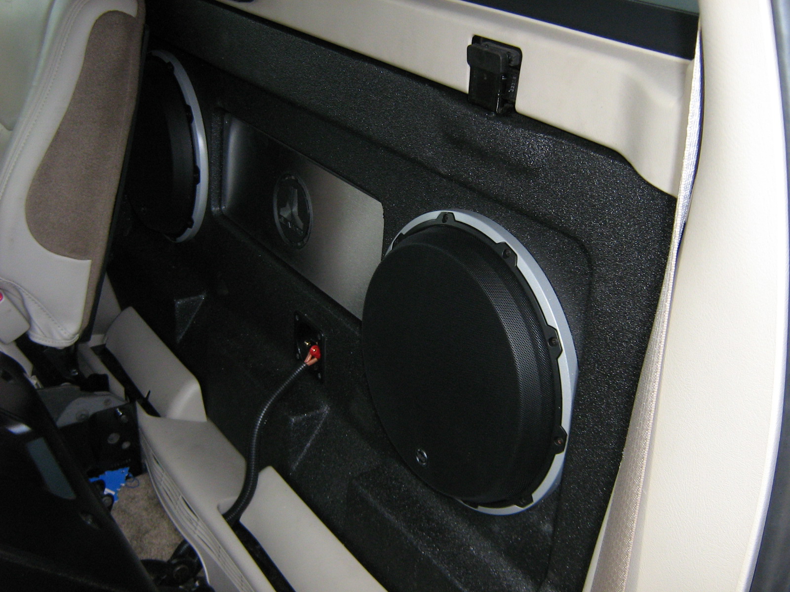

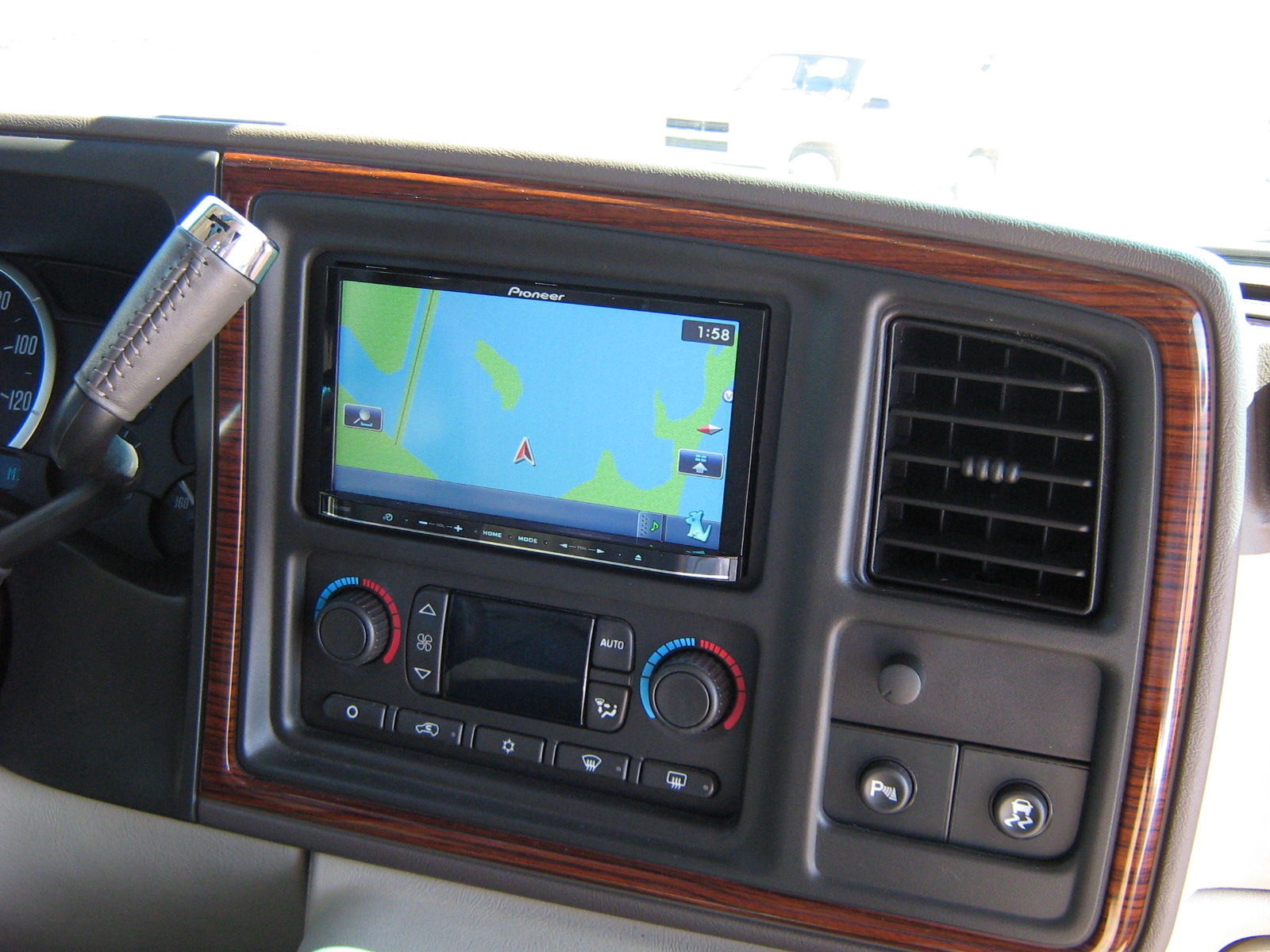

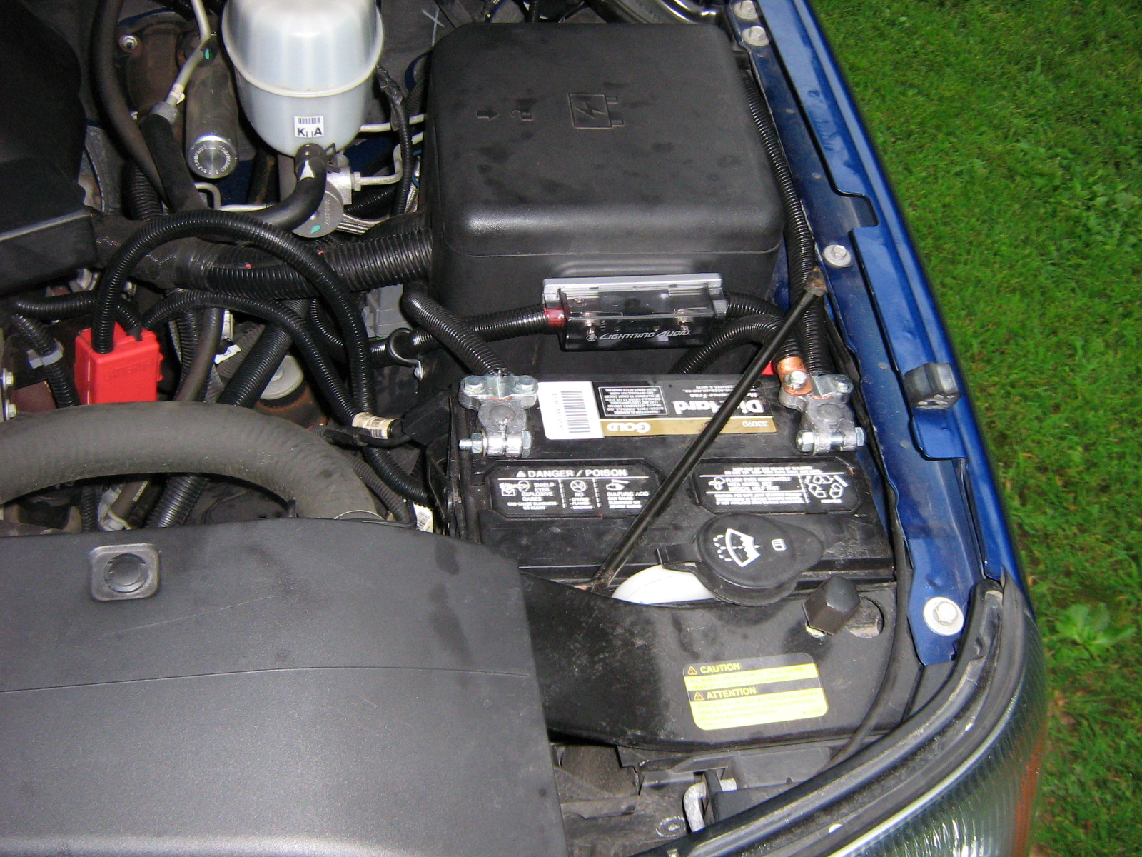

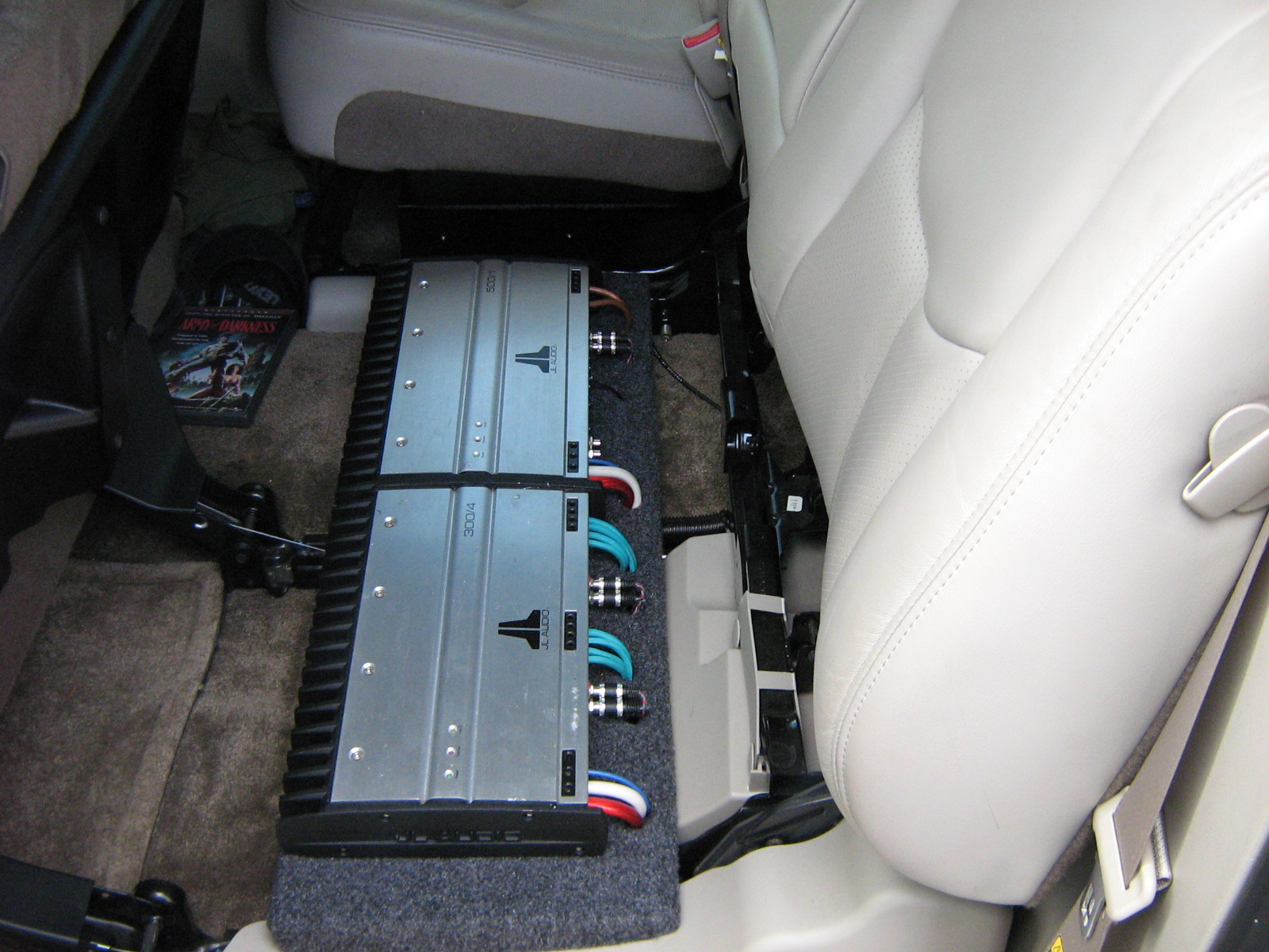

heres what we got goin on. the z110 bt head,jlaudio 300/4,500/1,four infinity perfect 6.5s.also a spare clarion dvd player where the factory changer was. speakers all wired with 12 gauge amps and second battery thru r/v continuous duty relay all wired with 1/0 tasty wire.jl audio stealthbox for ext with 2 12 inch w-6 woofers bring out the sub.and how.also installed by me [my job]. astro-flex 2-way remote start/alarm.dual batteries are connected while truck is running and by momentary push button in case of #1 battery failure to jump start itself.all of the interior lighting has been switched to cool white leds.also the drls and reverse lights have been replaced with leds.and yes the bypass has been done. ill put up the pics. the tray and relay are shown but the second optima yellowtop hadnt come yet.almost forgot about the reverse cam.also steering wheel controls are op. all protected by Colt gold cup 45 and my friend the mosberg persuader.
