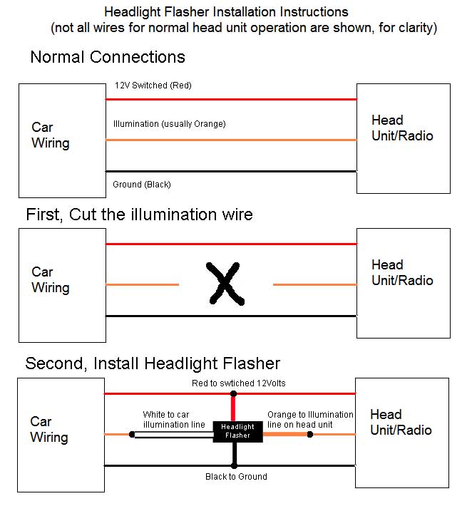

Well, easy is a relative term, but I believe if you can install the Avic-Z1 then you should be able to hook up this circuit. I made it as fool proof as possible. Instructions are posted on the forum but here they are again:
The installation instructions are in the attached picture below (again, you need to be a registered member to see the pictures):
1. Connect the head unit exactly as described in your installation manual.
2. Cut the line going from the car to the head unit labeled as the "illumination" wire.
3. Connect the white line from the head light flasher to the illumination line which is coming from the car.
4. Connect the orange wire to the illumination line which is going to the head unit.
5. Connect the red wire to the 12 Volt switched line (the red wire on the head unit’s wiring harness)
6. Connect the black wire to ground (the black wire on the head unit’s wiring harness).
7. Don't use the parking brake or disconnect that wire and leave it floating. Tape it up so it doesn't short anything.
