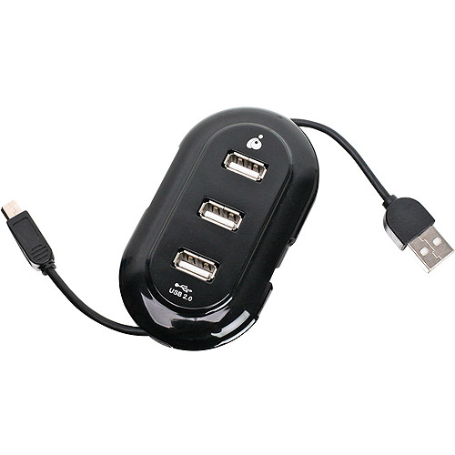

IHome USB 2.0 4 port Hub with mini usb as input, Optional split cable for external power source
1. Connect Iphone first and then USB drive
- Both iphone and usb works.
But iphone gives warning that accessory is not compatible and does not charge
2. Connect USB drive first and then Iphone
- USB icon disables and Ipod icon activates, Iphone gives warning and does not charge
- USB does not work, Iphone music works
3. Both usb drive and iphone connected to hub and Z110 boots
-Result same as 2
4. Only Iphone connected to Hub
-Iphone gives warning and does not charge but music works.
5. Only USB drive connected to Hub
- It works 100%
Belkin swivel USB 2.0 4 port Hub
-- Same results as iHome hub.
I also noticed that when using USB 2.0 hub z110 remembers it in memory(If not power down) and even if you disconnect USB or Iphone, Icons does not disables all the time.
I suspect mini usb as input for USB 2.0 Hub for iphone not charging. But i have to test it further with Single cable regular USB as input. If you get confuse reading this don't worry pictures will clear what i'm talking about.
