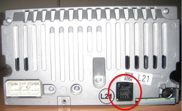

I'm pretty much a beginner when it comes to this stuff but I'm removing the stock stereo (Type E in the owners manual - 7 speaker) from a MY08 Subaru Forester XT (Australian Release) and installing a AVIC-F910BT.

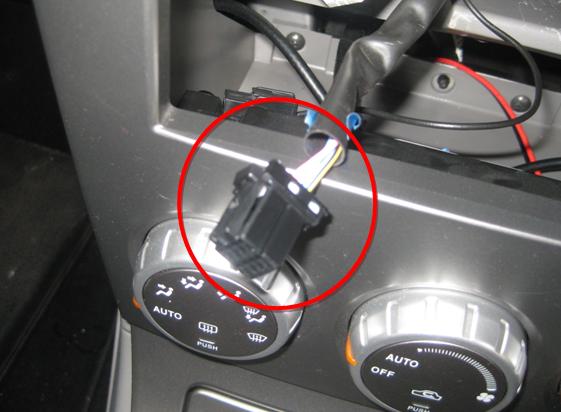

There is a 13 pin connector and a 8 pin conenctor (4 pins in use) to the stock stereo. While i have distinguished which wires are which for the 13 pin i have no idea about the 8 pin connector.
As mentioned there are 4 wires to this connector. Pink, Blue, White/Blue and Black/Yellow. I assume that 2 of these may be for the subwoofer (White/Blue and Black/Yellow) but not sure about the other two.
I'm hoping that someone will be able to help me out. Apologies if this is listed in another post but i have been unable to find it.

I should have mentioned I already have a wire harness. This harness takes care of the stock 13 pin connector. I can correspond each wire from the harness to the pioneer unit but i'm still left with the 4 wires from the stock 8 pin connector.

OK, so a little more research on the web and i found this site:
http://forums.nasioc.com/forums/showthread.php?t=749402
Wiring colour is slightly different for my Forester but pin placement is identical.
Pin 3 (Pink) and Pin 7 (Blue) - Steering Wheel Controls
Pin 4 (black/yellow) and Pin 6 (white/blue) - subwoofer
