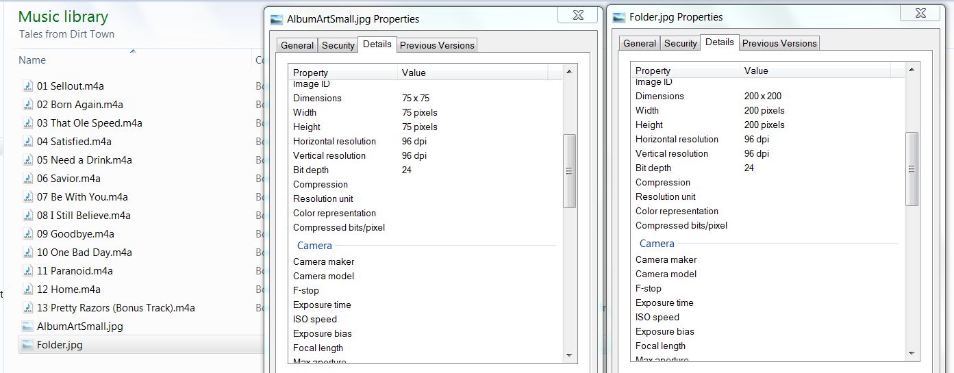

Have you tried to download all album artwork in Itunes lately? I do know that there is at least two different resolutions... one for regular play, and one for coverflow....
Posted Feb 16, 2010 · 02:20 UTC#6
Here's an example.... I'm not exactly sure on Mac OS... but in Windows, if you hit ALT, then select tools>folder options>view>then uncheck "Hide system operating files".... you should see the two... Folder.jpg and AlbumArtSmall.jpg
If not, then try to use the download album artwork function in Itunes...
