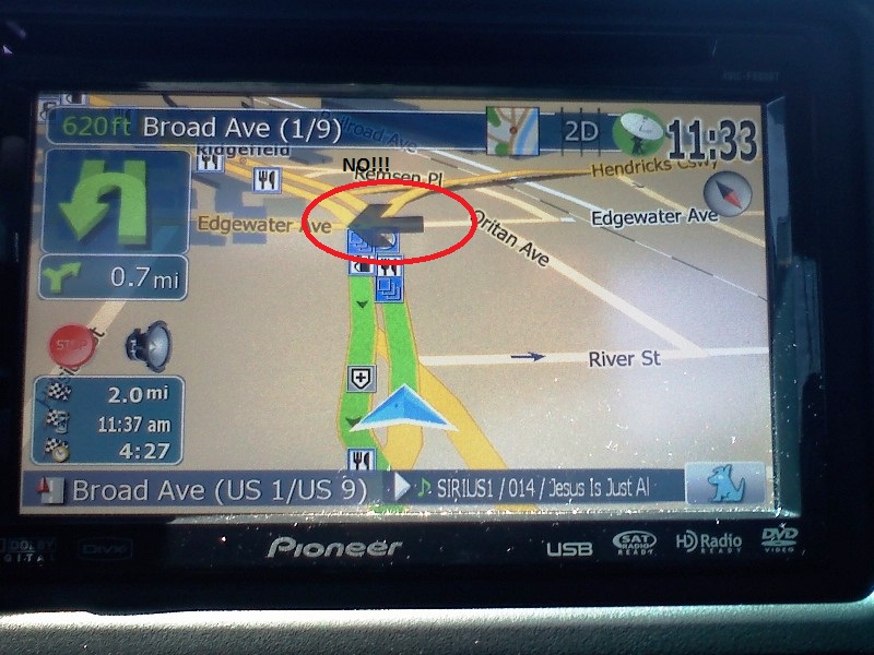

Hello, I want to know how can I do to have only the drawn arrow on the street like in the picture (green arrow), which file should I change?How? Thank's! :)

Actually, you *want* guidance strip and you don't want guidance arrow. Use this in your sys.txt:
[3d]
show_guidance_arrows=0
show_guidance_strip=1
