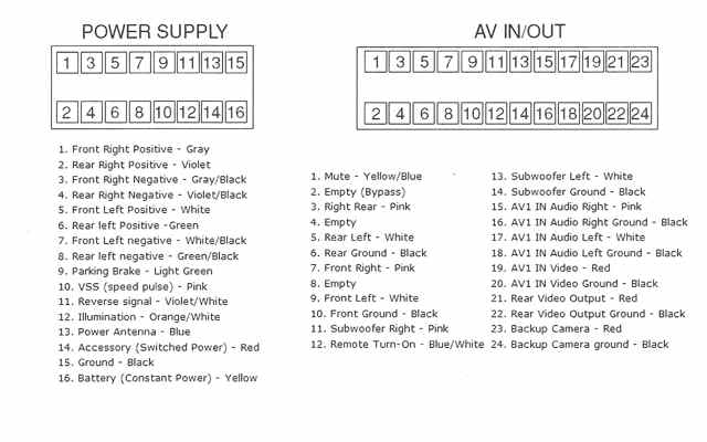

I'm new to the thread. I just purchased an X910BT and would like to hook it up to my car. I found out that there are two types of speaker output (correct me if I am wrong) According to the pinout, pin1 to pin8 from the Power Supply cord seems like where I should hook up my speaker wires to. I also found that pin1, 3, 5, 6, 7, 9, 10 are also output ports to speakers. I am now confused that which one should I go. I understand the AV IN/out contains wires with rounded plugs (sorry for bad expression) whereas the Power Supply output are just plugs. My car is ML350 03 Mercedes. I do NOT have amp nor sub and I have speaker level output wires. Any advice? :D

Use the 1 to 8 wires on the Power Supply cable. The wires on the AV cable are unamplified and would only be used when connecting your X910 to an amplifier.

oh great! then I know my specific wiring now! thanks a lot!! :D

I also found that pin1, 3, 5, 6, 7, 9, 10 are also output ports to speakers.F900Pin-Outs.jpg
it clearly says that 9 and 10 are for the parking brake and VSS.
