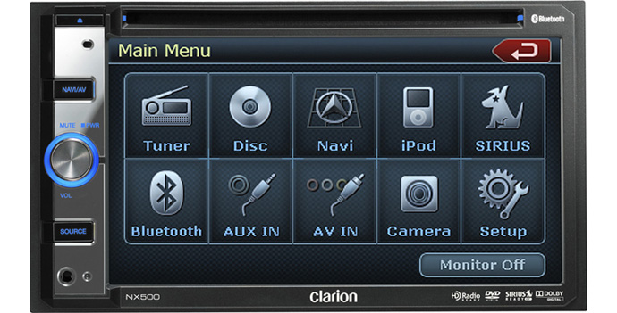

I think I will just be getting this unit then: http://www.clarion.com/us/en/products/2010/multimedia/navigation/NX500/us-en-product-pf_1259394334521.html
I tried the bluetooth on this device at a local store today and it was superb, not only is the system super quick to respond but it's pretty much a AVIC on steroids for 649.99 at the local store. It also has bluetooth stereo so if I want to pair a phone that contains plenty of music it will appear in the bluetooth menu which I found pretty cool.
I am really upset though because my entire car is Pioneer brand excluding the cap, I have a 12" sub and 720amp from Pioneer as well replaced the stock speakers. I wanted to add a little Pioneer sticker on the fender as well, I was a big fan of Pioneer products since I was a kid, so I always saw as Pioneer as quality but over the years I heard their products moved overseas amongst every other company and their quality suffered.
I was told by many to try Eclipse or Clarion, and so far something within my price range is the Clarion.
