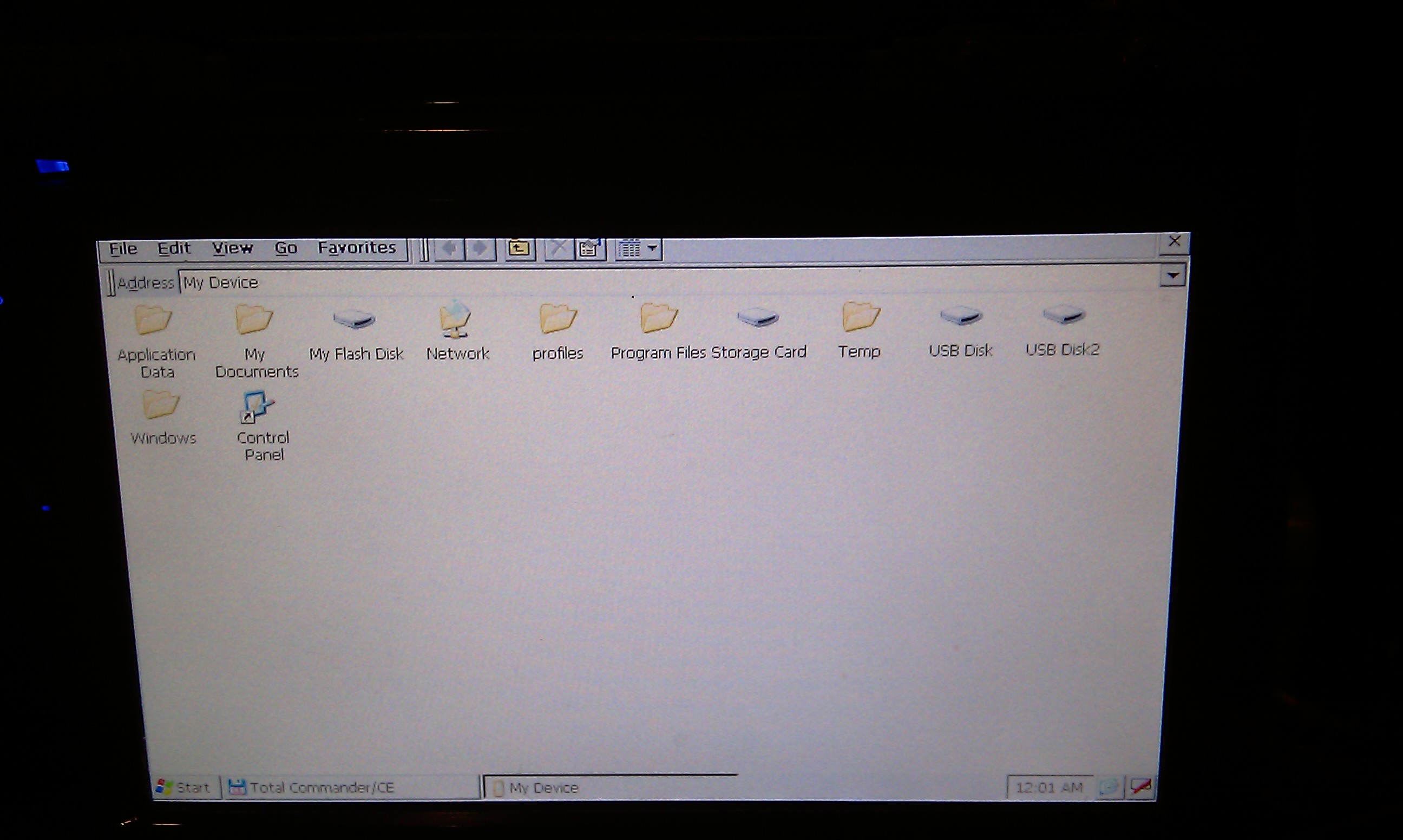

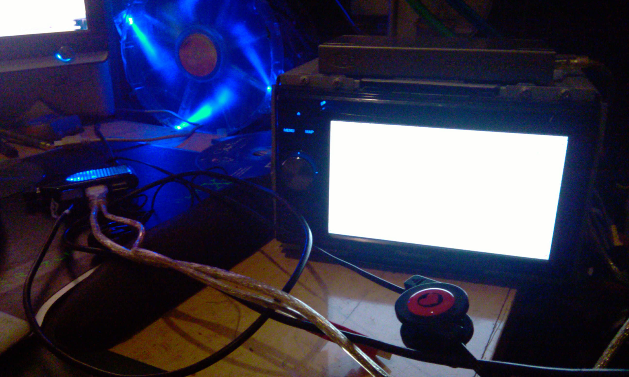

I haven't install my unit yet, so is near my pc, and i'm trying to get htc sense work on the avic..yes i know i'm crazy :-)...while i was doing this i saw the usb hub near my pc, and i had the idea to connect to the avic.....surprise!!!!
i connected the portable hard disk and worked!!! than i connect my hd2 too and the phone reconized a usb connection, but the avic saw only the phone...so i started in test mode and surprise again!!! the avic saw all the storage card...my phone, 8gb and my hard drive, 100 gb,usb disk and usb disk2!!!....so i realized that the problem in the pioneer interface is only the missing usb2 shortcut because the audio section is the same for all the usb storage!!!!!
Anyone can help me to found out in the pioneer code how to add a shortcut to harddrive????
Please help me, i think is a good feauture for our device!!!!
