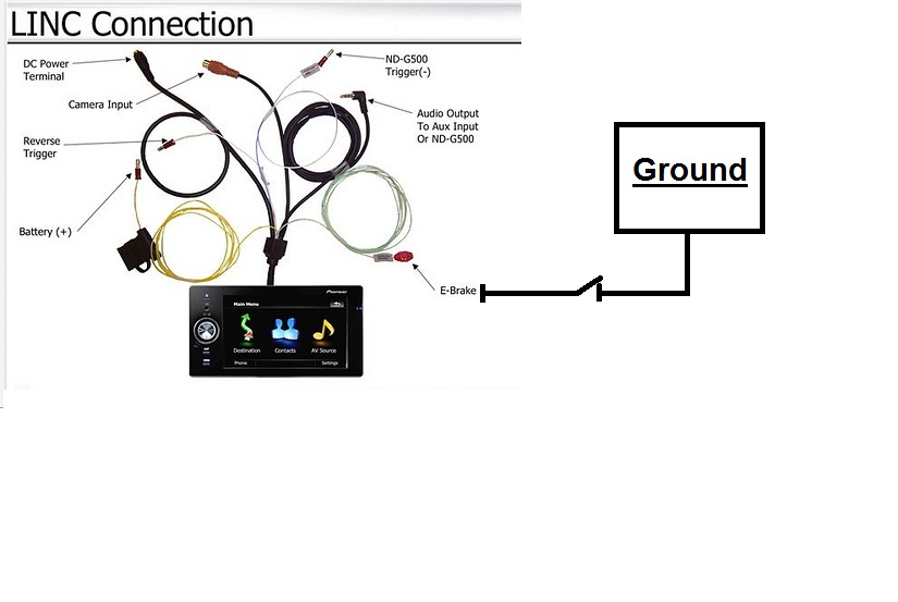

Hi ,
every one he has Pioneer Avic F500bt
i have Bypassed mijn after along time of searching in the internet I was sad that i can't find the way
but after i read the Bypass for Avic F700bt and the speaking about breaking park speed and cutting wires
i went to my car i toke my avic out and all cables then i found the breaking park wire witch has this lable
" breaking park "
****** Conect this wire to the Ground wire ********
That's it .......Done
Now I have fully control of my avic
playing video while driving
using all settings
full control of my Nav
full control
I hope that i did something makes the owners of the avic F500bt happy
if some one else found this way and post it here and i did not see it before sorry for this because i was tired form long searching and i did not find it beforeAttachments
