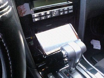

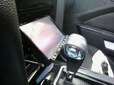

I am having and annoying serious problem with my avic z3. I took it to a shop and had it put in a 2010 mustang and they said they unlocked it. And it was fine for a week. Now when I turn my car off the screen tilts down until it hits the shifter and then stops there. When I get back in the car it doesn't go back, i have to hit the tilt button several times and manually put it back up. This is my wifes car, she doesn't want to drive it now and I need to get this fixed so she will. I hope someone know whats going on, this never happened in the previous vehicle it was in (2008 scion xb) I dont want to blame the shop but after they unlocked it, thats when it started happening. If it hits the shifter will it break anything inside of it? or is there a safety? Its so freakin annoying.

Can you post a picture after you turn off the car?
Posted Nov 05, 2010 · 14:26 UTC#3
yes pop back in , in about 20 min
Posted Nov 05, 2010 · 14:57 UTC#4
here u go, hope this helps. Sorry bout crappy res. I might be able to get a video up here tomorrow afternoon as well.

Posted Nov 05, 2010 · 17:34 UTC#5
I'm stumped. Unlocking did not do this...
