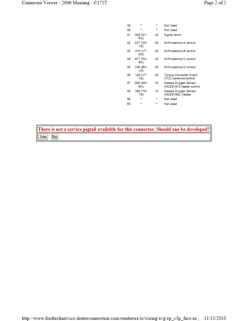

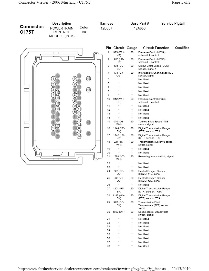

Ok I stand corrected, Mustangs are dumb. Pin 14 in the radio harness is the VSS on Fords with the 24 pin radios. I looked in the 05 up shop manuals and they use the network for VSS signal for the factory radio. I am trying to find the VSS wire for your car and will post back when I find it.
Posted Nov 14, 2010 · 04:21 UTC#11
Ok Mustangs 05+ use the Output Shaft Speed sensor(OSS) from the transmission to the PCM and then the VSS is a network item. So you can tie into the OSS signal at the PCM. It is going to be pin #3 on the transmission harness at the PCM connector. It will be dark blue with yellow tracer. I attached a picture of the connector you need. Hope this helps.

Posted Nov 14, 2010 · 21:05 UTC#12
Thanks for the info. I'll let you know how it turns out. Do you happen to know if there is any voltage on that wire?
Posted Nov 14, 2010 · 21:31 UTC#13
Once the vehicle starts moving there should be voltage on it IIRC.
