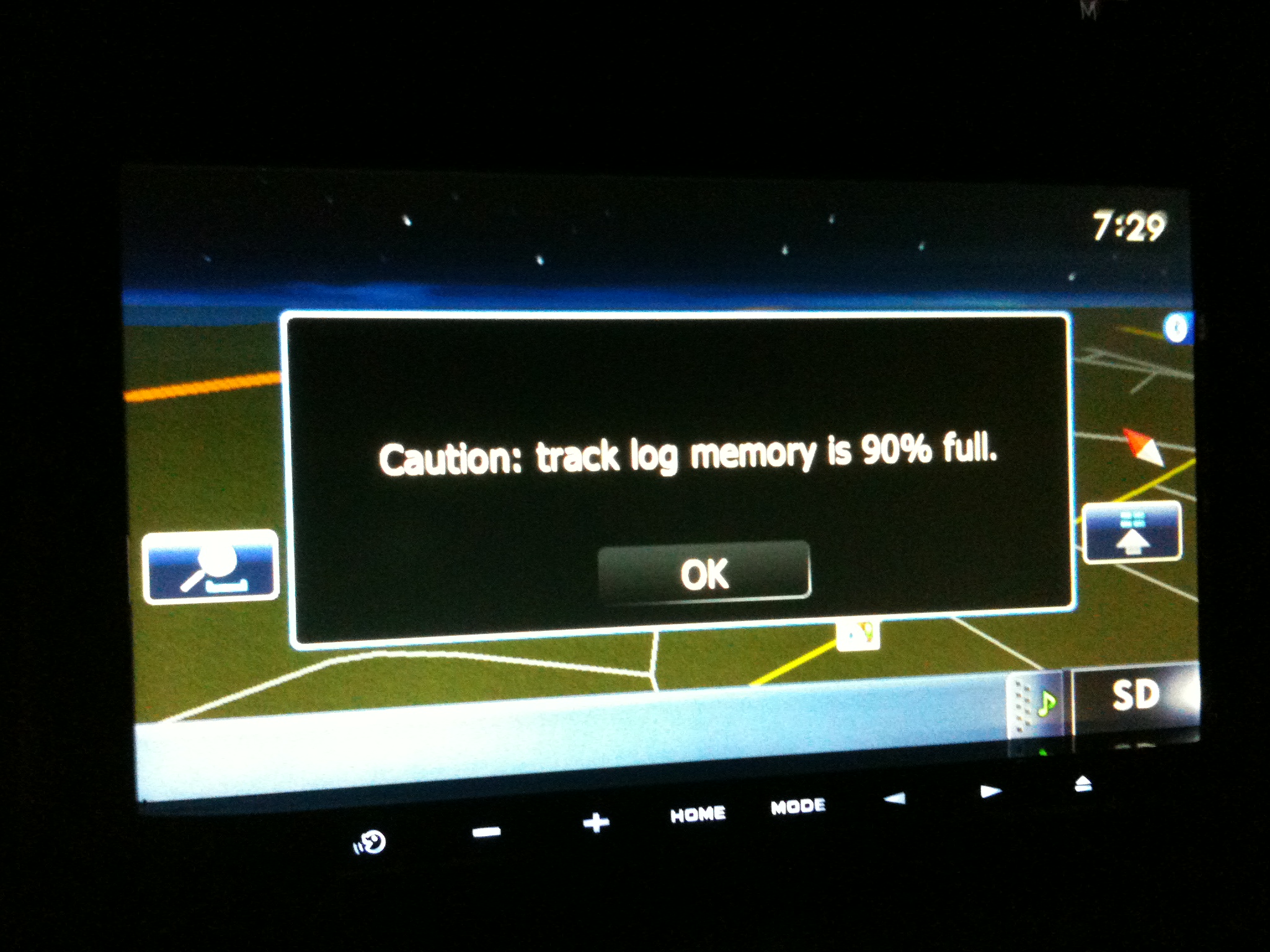

A few weeks ago I started getting this pop up every time I turn on the navi. "Caution: Track log memory is 90% full. Im guessing It has to do with the SD card that I use for playing music. Any ideas how to get rid of it or what it is? Ive also attached a picture.

Yup. Turn off logging in the Navi settings. If you are interested in seeing the logs (and everywhere you've been in the last few years) insert the SD into your PC and run AVIC FEEDS (download from Pioneer if necessary).
