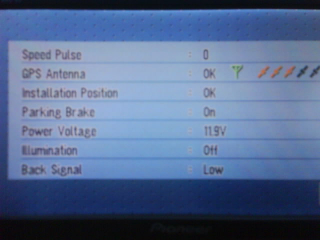

After adjusting the placement of my GPS antenna, I managed to lock several satellites (see pic)
But it doesn't seem like the navi-unit figures out where I am on the map...what should I do?

Are you using Europe or US maps ? US pioneer units only come with US/Canada maps.
Posted Jan 04, 2007 · 18:42 UTC#8
I am using map for Europe, CNDV-60M (2006-version). It is a downloaded version though, maybe something is wrong? I can't search for POI or city/street. It says NO DATA ON DISC. The US map discs that followed my AVIC works fine, but don't cover my area :wink:
This map is originally for AVIC-Z1, but Pioneer service in Norway ment it should work on AVIC-D2 also.

Probably your best bet is to make sure you have a working disc . Maybe a shop that installs Pioneer units would allow you to insert an original disc to see if that clears your problem ?

If you are receiving at least three sats, and your map has you off course, it almost has to be either:
the software of the unit, or the software of the MAP source. I believe your problem is the map software. Reason is, somewhere on my journey via the Internet, and researching Tele Atlas maps, and different company's websites in regard to Navigation units, I ran across some type of statement about the discs containing different internal operating software for the units that require a disc inserted at all times, versus a unit that loads the mapping software totally on a hard drive.
