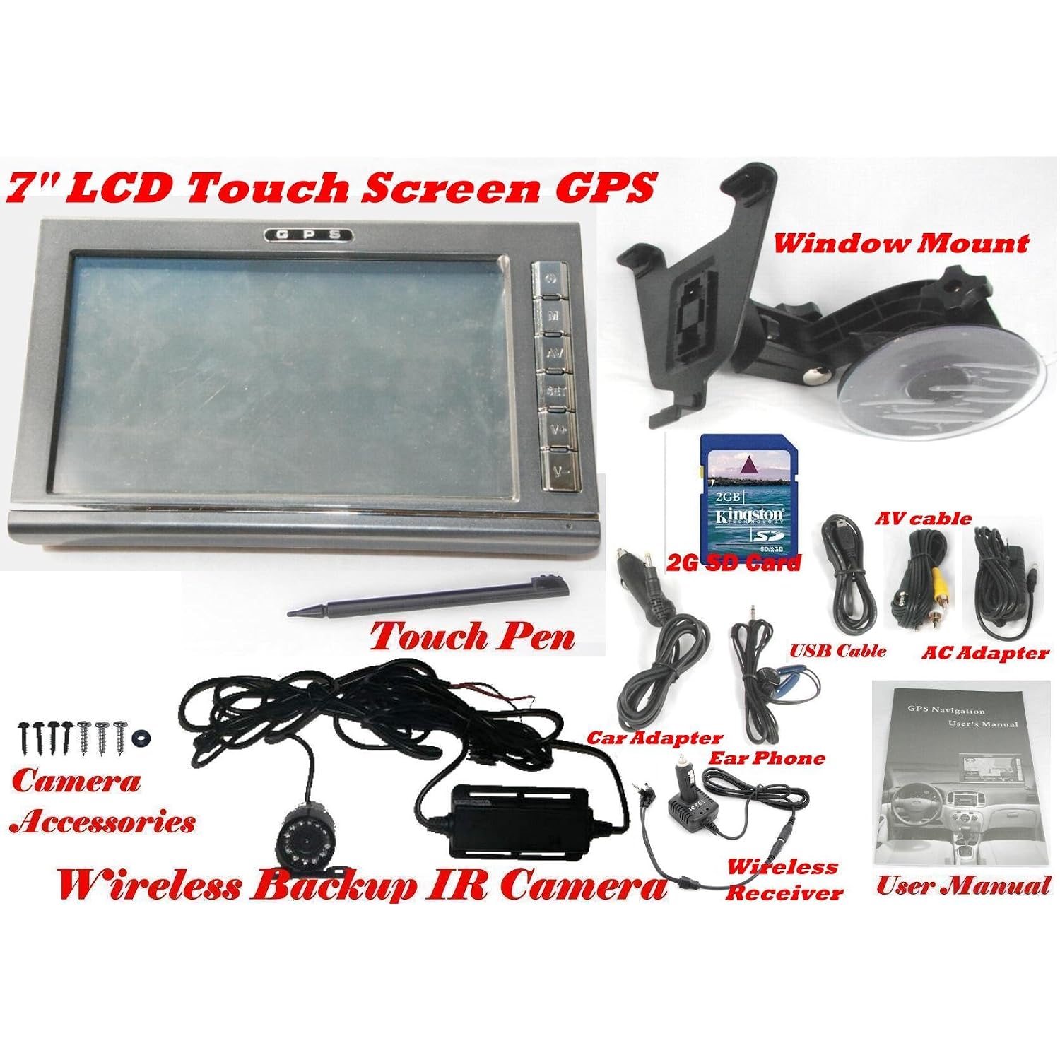

Looks nice and factory so let's try and imitate that. But a carputer is wayyyyy too invovled. So I thought, what about installing a navigation like TomTom. That lead me down a path of looking at Navigation units with back up cameras (4UCam : http://4ucam.com/ ) which ultimately lead me here.

3. If I did the above, I could use 4UCam's setup no problem but it runs about 400 bucks or so for their units. It also would require, should I want to listen to my ipod through the car stereo, that I buy a seperate adaptor that plugs into the cd changer in the trunk... that costs around 150 bucks and can be seen here : http://www.incaripod.com/Vehicle/Range_Rover/ICD_Direct_Control_iPod_Interface
In other words, to get ipod music, ipod video, bluetooth, gps, av in (for watching movies), I would buy a 4ucam (400) and a cable (150)... that's a pretty penny. However, it would have a lot of functionality.

This is the other option... not as sexy but I wouldn't be tying anythign into the head unit which would be easier (though I would need to spend another 150 to buy a cable to hook up ipod to head unit)
