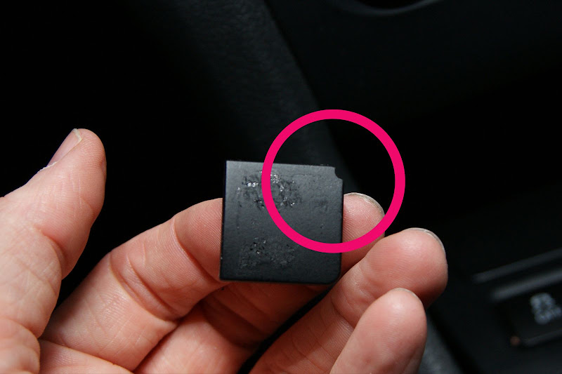

I have not installed the microphone by the dome lights yet because I want the dealership to fix the rattle in the headliner first. After that I might tackle that. Until that time I have installed it on top of the place holders for the buttons in front of the shifter.
To feed the cable up I filed down a corner with a small round file so that it sits in there loose enough that it doesn't tear when the microphone gets moved - which happens quite frequently.
Since I also place the iPod cable in the ashtray (for now) the following instructions on how to remove the ashtray to be able to comfortably run the cables down apply for both cables.
(Please disregard the glue on top. The microphone recently decided to come unglued. I will soon try a different installation method)

What JL97VWGTI had done was actually quite smart and looked great too. At the time I was just not brave enough to cut up the buttons of the ashtray. I'm still not sure that I am but I might do it after I know how much a replacement tray will cost in case I want to take out the entire installation when I sell the car. (Something I had intended to do with the trunk installation of my subwoofer in my 2001 Golf TDI but then didn't after all.)
JL97VWGTI had cut up a dock and installed the tray (for lack of a better word) in place of the buttons. It actually allows for the iPhone to rest against the middle console just below the climate controls.
Mind you for those instances when you want to be able to control the iPhone/iPod directly without having to take it out of the dock it would be even better if I could figure out a way to mount it on the same level as the radio.
Unfortunately I am someone who doesn't like messing with the original design too much. So I will be working on installing a dock next to the ESP button.
There is another thing that is still stopping me from doing that though - aside from cutting up the button spaces. The Pioneer iPod cable clips into the iPhone and requires manual unclipping. So until I figure out a solution to that problem the cable will feed up through the hole in the bottom of the ashtray.
Whether or not that complies with the new hands free driving laws that state the phone has to be affixed to the car is a question I can't answer.
But a lot of the time I don't even take my phone out of my jacket pocket. Instead I will let it connect via Bluetooth both for voice as well as audio. You can definitely hear a difference between Bluetooth audio and direct connection audio, but since I am not an audiophile I was able to find EQ settings that make it OK for me. (More to that in my alternate post.)
What I didn't know about at the beginning when it comes to Bluetooth audio is that you don't just have control over PLAY and VOLUME but the TRK buttons will also allow you to skip forward and back which now only leaves two options on my Bluetooth interface wish-list: SHUFFLE SONGS and display the song info, possibly with artwork although the latter is not really that important.
Mind you this may already be an option and I just haven't figured out how to use it with the new Bluetooth firmware version 3.1 (I still haven't dared to upgrade to 3.1.1. Maybe when I get home in the New Year.)
