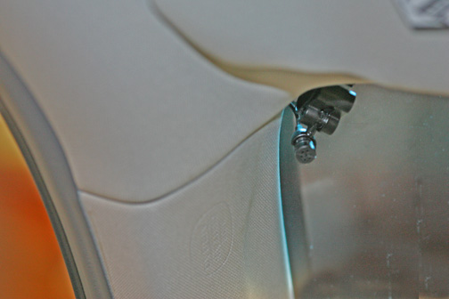

Posted Jan 10, 2007 · 19:19 UTC#6
I agree with all that position of mic is key to eliminating/reducing echo. I have mine installed by a professional who has installed more than 60 Z1s.
Here is a picture of the Z1 installed on my Infiniti Q45,
http://picasaweb.google.com/pnanda/06De ... 3124927538
I have my Z1 phone audio volume at more than 3/4th. My phone when registered with the Z1 had its volume set at half. No echo complaints after heavy usage for a month...

Posted Jan 17, 2007 · 16:29 UTC#12
i am getting my Z1 and bluetooth soon. and i was wondering if someone could post some more pictures because i don't really know where you guys are talking about. i am having it professionally installed and i want to let them know where exactly i want it so there is no echo effect. i drive a ford explorer. thanks for the help. if anyone could add some more photos so i can get a more accurate fit for the mic. thanks
