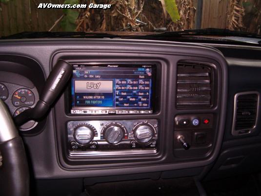

Pic of Z1 Installed in 02 Avalanche (Din and a half)
By 420greg · Jan 14, 2007in General💬 10 posts👁️ 1,588 views
Posted Jan 14, 2007 · 00:11 UTC#1
Had to lower the climate controls, switch to an 03 Console Bezel and cut about 1/4 inch of the ashtray lip.
Posted Jan 14, 2007 · 00:20 UTC#2
But it looks good. Nice job.
Posted Jan 14, 2007 · 02:08 UTC#3
Is it sitting crooked or is it just my eyes?
Posted Jan 14, 2007 · 02:16 UTC#4
I don't think it's our eyes I see it too. Could just be the picture.
Posted Jan 15, 2007 · 03:06 UTC#5
I have an 2002 Silverado LT Ext. Cab and figured that the AVIC-Z1 couldn't be installed in it , but this gives me new hope.
1. How does the 2003 console bezel differ from that of the 2002 console?
2. Was it difficult to lower the climate control? Did that require any additional fabrication/cutting?
Please elaborate on the install.
Great job though! It looks really nice! :D
PS :shock: I don't see the crookedness that was mentioned in the previous posts. Was it installed crooked?
Posted Jan 15, 2007 · 03:26 UTC#6
it definitely does look crooked. It looks like there is more trim on the top right side of the Z1 than the top left side. Still looks like a really sweet install! I love the look of double din displays like the Z1/D2/D3
Posted Jan 15, 2007 · 04:00 UTC#7
It actually looks more like its angled towards the driver, and thats why it looked crooked.
Posted Jan 15, 2007 · 05:25 UTC#8
That's what I see Sportsfan21,
It looks like the bezel console angles inward towards the driver which was most likely GMs intent for a more ergonomic design. That along with the angle of the camera when the photo was taken, may have contributed to making the AVIC-Z1 appear to have been installed crooked.
I guess we'll just have to wait for the reply of 420greg to find out if it is in fact crooked and if so, perhaps it had to be installed a little off kilter due to possible tight tolerances which may have not been able to be avoided.
So say you 420greg, crooked or not? Either way, it's quite an achievement to get it to fit in the space that Chevrolet allowed you. Or should I say, didn't allow you :twisted:
Bravo
Posted Jan 16, 2007 · 00:40 UTC#9
It's not crocked, The dash is angled toward the driver.
The is some cutting of some metal from behind the dash.
I just followed this guys thread and it went pretty smooth:
http://www.chevyavalanchefanclub.com/ca ... 758.0.html
The only difference from the 02 bezel to the 03 bezel is the location of the plastic bar that seperates the climate controls from the HU opening. The install took less that 2 hours.
Posted Jan 16, 2007 · 00:52 UTC#10
You guys are absolutely right. I can see now that it is angled a wee bit towards the driver. I think that is awesome. i dont play DVD's on my N3, and think it would be a huge convinience to have the screen angled a bit toward me while driving so I can glance at the Nav screen easier!
Like I said earlier, it definitely is a sweet install, 420greg!
