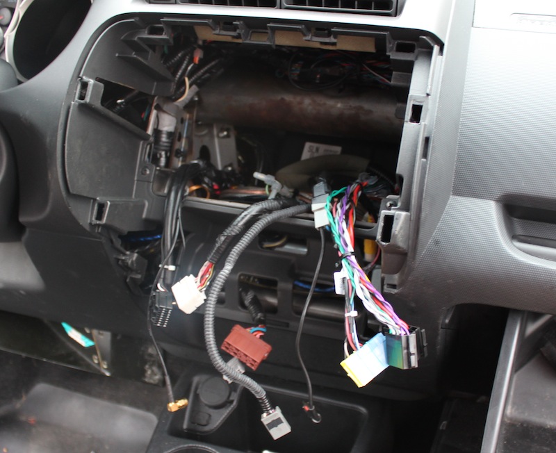

Posted Jun 28, 2011 · 00:59 UTC#5
So i spent time after work pulling out my broken AppRadio and get ready for tomorrow's replacement...
while I was back there I thought I'd take a few pics of the differences in the wire harnesses just in case anyone was curious...

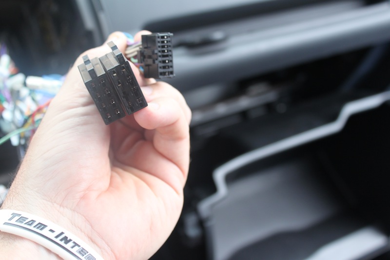

Power/speakers (F700 on right, AppRadio's 2 plugs on left, which are a lot like Blaupunkt and/or VW plugs)

All ready for tomorrow's re-install!
