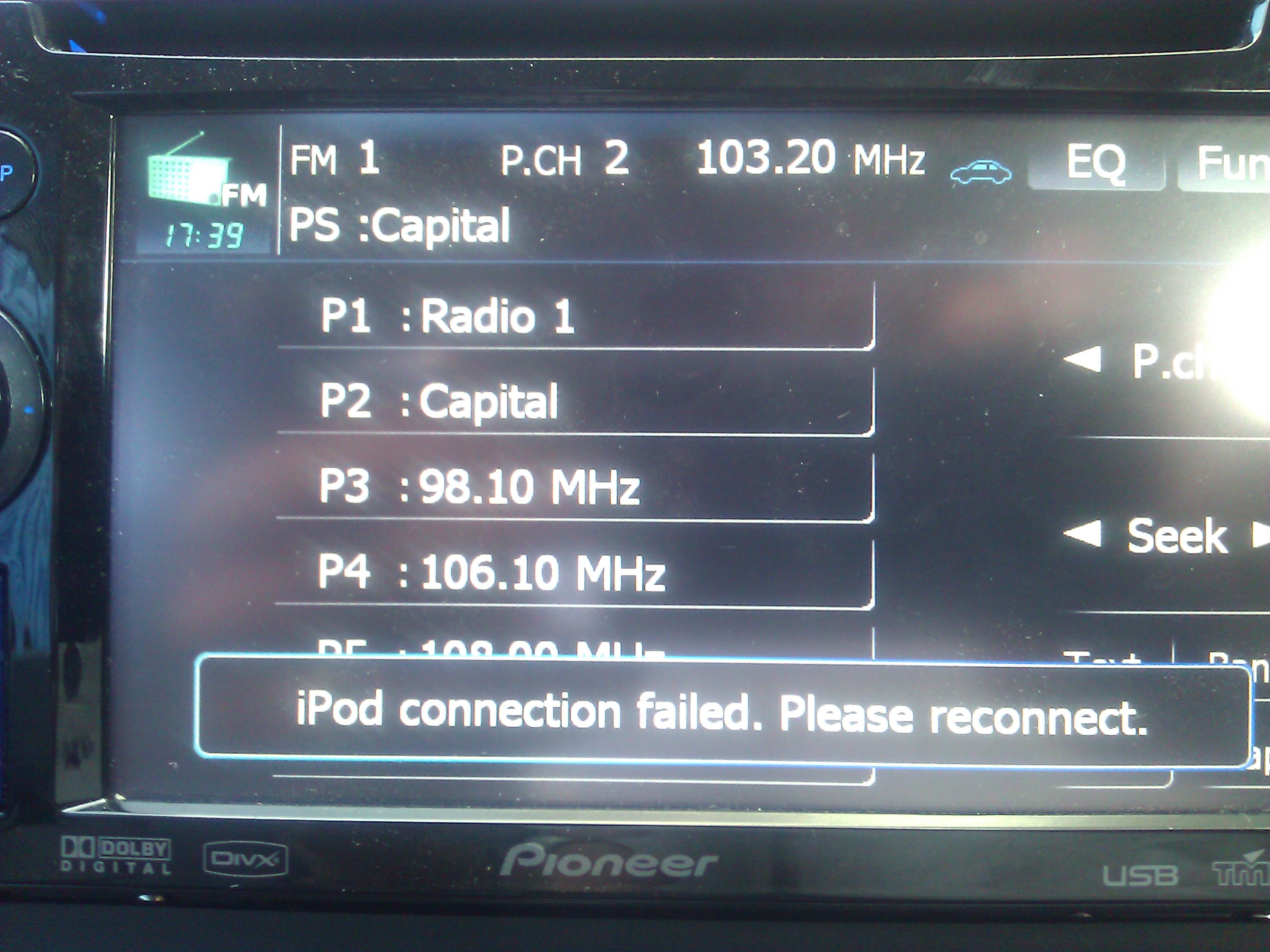

Posted Jul 01, 2011 · 09:08 UTC#2
Just did it again! See attachment.post-53310-0-93174700-1309511324_thumb.jpg
