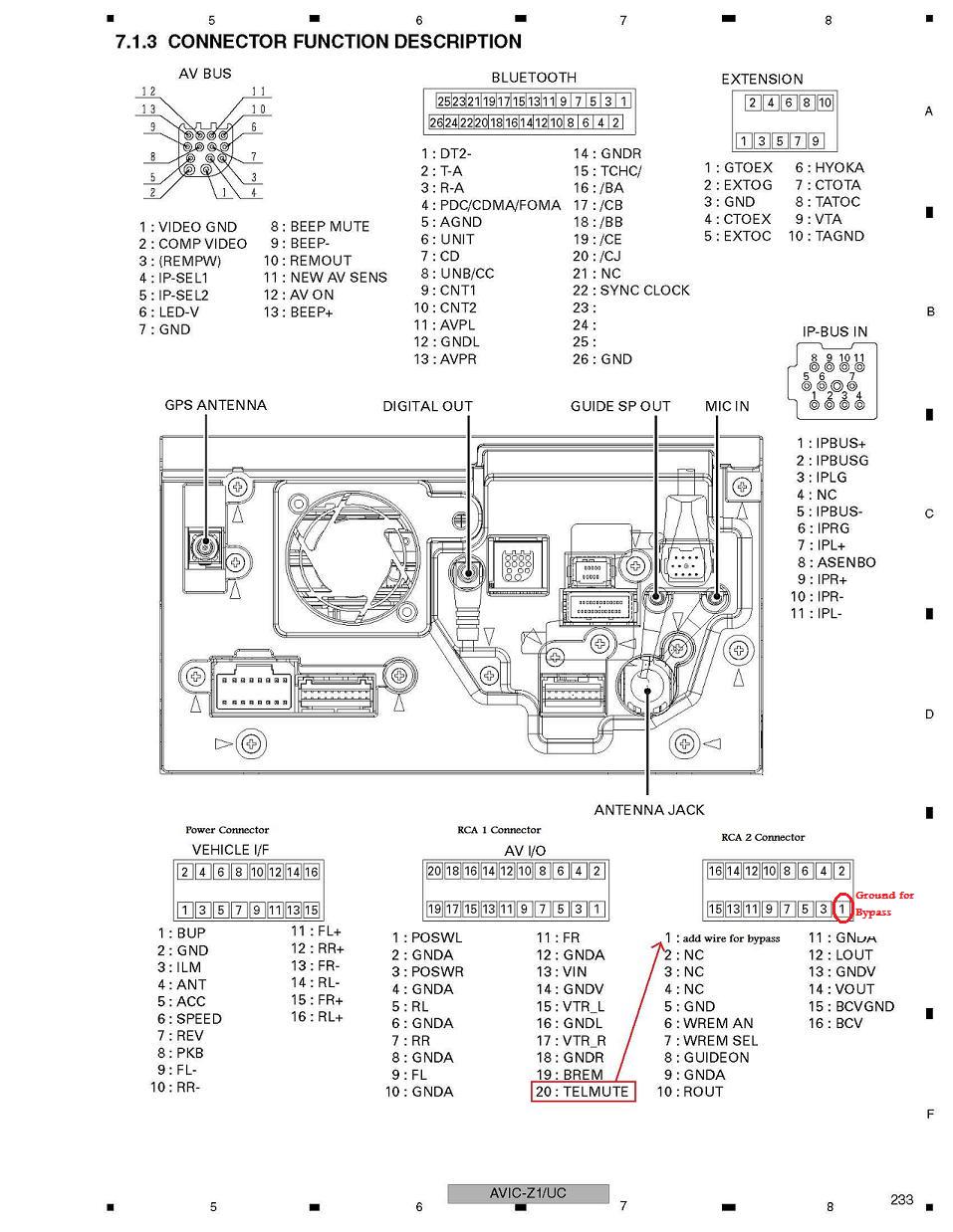

i guess i just realized i might be missing the swc harness??? i have 2 harness room for one more.. Im trying to get my axxess swc to work only input is the digital out 3.5mm input i can see on unit??? my car came with z1 fairly new to me i got a camera coming too but seen no input besides video in?? n e help wwould be appreciated.. the swc came with a female 3.5 with two wires coming out is that how i can hard wire it to a pin using d sub connectors??? i would need to know what pin position it is?? if im wack cuz im newbie all good id appreciate n e help or criticism lol!!

You are missing 'RCA Connector 2'. It contains the connections for SWC, Rear Cam, Rear monitors, and 'guide on'. This is also the same connector used for the 2 wire bypass.
The Pioneer part number is CDE8084 and can be ordered at http://parts.pioneerelectronics.com for $40.45 plus tax, shipping and handling.
I have attached a pinout diagram for the Z.
Bypass: pin 1
SWC input: pins 5, 6, and 7
Rear Cam input: pins 15 and 16
