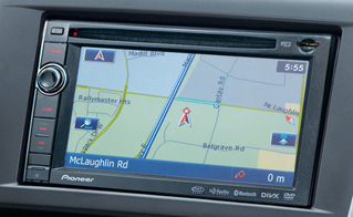

Here is a picture directly from Subaru.ca website:
It looks exactly like the X930BT, the only difference is this model of the AVIC, is named X9310BT, which is the model for automotive dealers, and when I called Pioneer, there is no physical difference other than the model #.
So if the green wire is connected to the handbrake as it should be, should I just cut it and ground it with the yellow wire? That's my biggest question!
Thanks,
JP
