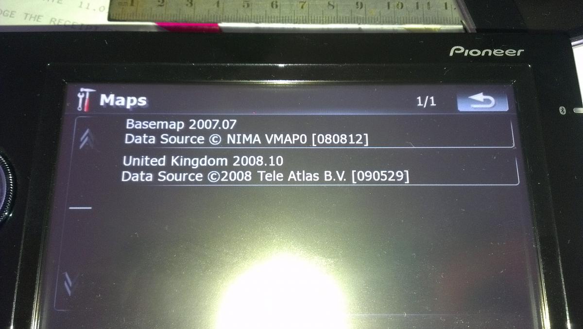

Hey there,
Recently ressurected this unit as it had a broken touchscreen. As far as I'm aware my unit is running the FX3.1 mod. S/W and Map versions as per the attached screenshots.
The odd thing is that the UK map I'm using has a lot of blue areas - it's like I'm driving in the sea!
Any ideas where to start on this? :?

Hi,
I had the exact same issue! Updated to latest firmware from pioneer website and it fixed the blue areas. It's states there is a fix in the firmware notes to fix the blue areas.
Hope this helps!
