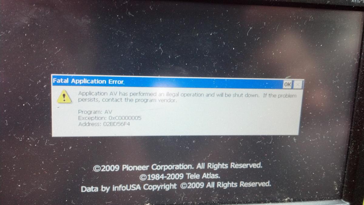

When i tried to fix my F700BT it seems that i broke it even more. when i go to boot it i get this message post-44470-0-45597200-1344105599_thumb.jpg please help as i would like to enjoy my exspensive unit again.

Disconnect all inputs iPod, rear view, USB ect and try doing backup again

im trying to find the win ce file but all the links seem to be dead...anyone got a live one?
Posted Aug 05, 2012 · 06:01 UTC#4
http://www.enkrypted.com/4.01.zip
Unzip this straight to the SD card and update WInCE first (Format option on the top) then load the files into the my flash disk as needed.... good luck!
