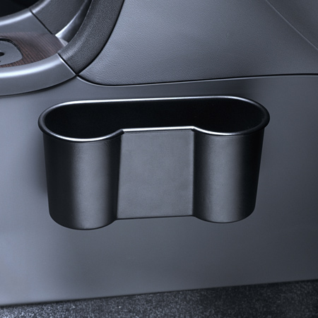

On another note I moved my ipod cable to the center console. Take a look.

Nice job on the iPod. I ran the cable for mine to the passenger well where I have an optional Saab holder installed.
