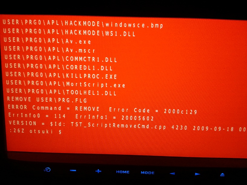

I then decided to try the HACK mod to see if the files were in the correct spot using the auto hackmode from http://avic411.com/i...dated-24092012/
When I ran that I got an error message seen on the attachment. post-35397-0-52825900-1348576173_thumb.jpg
I then tried an older card info file I got from the shortfuse crack and it didn't work either. Nothing has worked and my unit will not boot up past the boot splash screen.
Anyone else run into this problem before? Is there a way to fix it?
