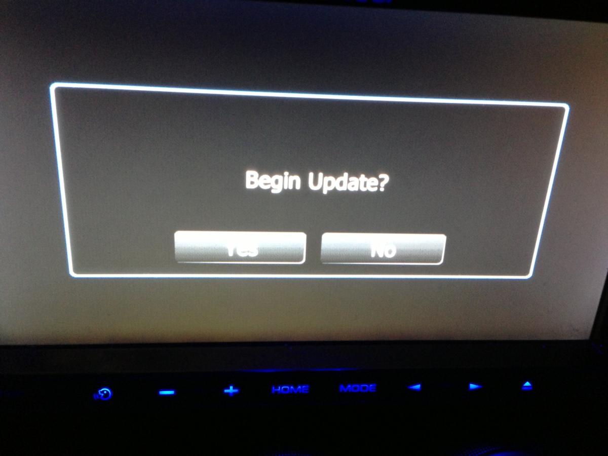

So, since I have had no replies so far... I tried on my own.
I put CARDINFO.cif on the root of the SD, I made a Firmware folder and an Update folder.
In the firmware folder is... 2012 Upgrade.rar
In the Update folder is... VERINFO.DAT
Inserted it in the head unit and received the picture below...
I was excited because I thought I figured it out... But instead after the reboot I ran into this message...
(sorry for flipped picture)
I managed to get it into test mode and get it back to normal, but I'm not sure what I am doing wrong.
Please someone help me I would really appreciate it.
I just want to get this updated.
Thanks....
