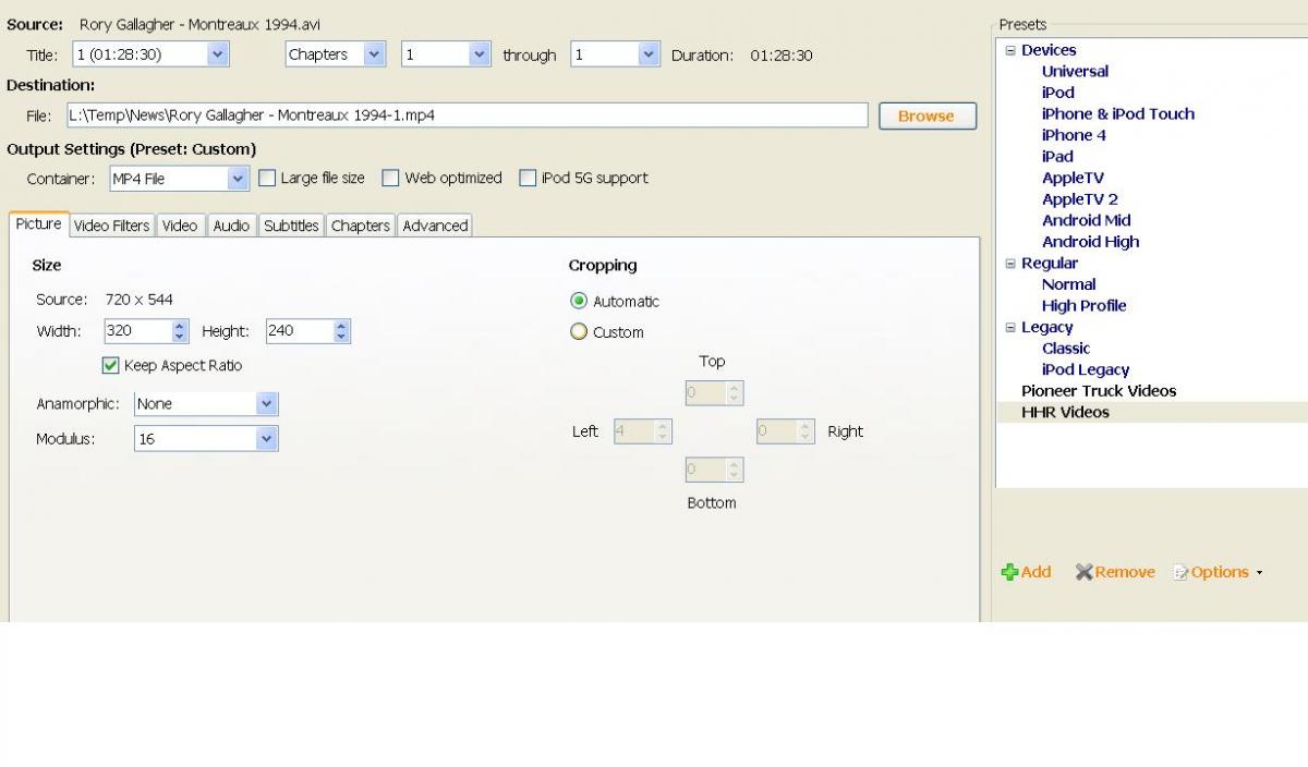

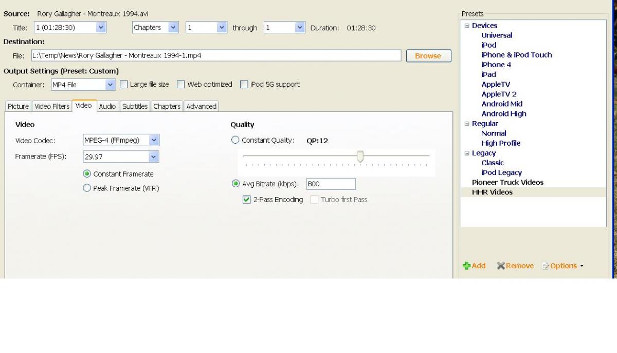

The screen on my X950BH dims or changes color when it senses the headlights are on. I would check the way you wired the adapter (if you used one) is wired to the lights since a lot of cars run with lights or running lights on all the time now. As for the videos not playing, you did say if they were ones you burned or a commercial? On mine videos would not play the same videos my X940 would play and some it would? There are some posts on the site here to show the settings for the Handbrake video editing software and they give a very good starting point. I did the same video with several different settings and finally found one that worked well. I have attached two screen snapshots of MY settings and yours might have to be different.
I run my videos and songs from a USB thumb drive kept in the glove compartment but the format of the videos is what is important.

One of the quirks I found on this model was the seemingly inability to adjust video size such as my X940 could do. That one was much more forgiving with the screen dimensions where the X950 seems to want them to be exact.
