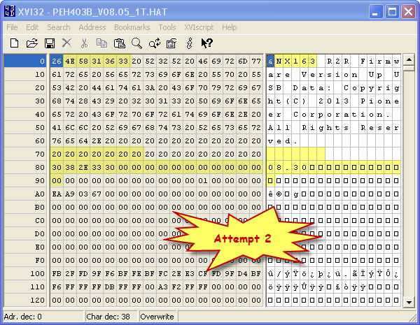

There is a method for "tricking" the firmware upgrade process, so you can downgrade.  Simply open the PEH403B_V08.05_1T.HAT file in a HEX editor (XVI32 is free and easy to use), and change the version number, which spans the decimal addresses 136-140.  In this case, you'll be changing "08.05" to "08.30".
But that's not all.  Since you're dealing with a different model than the firmware dictates, we'll need to break down some additional differences between the AR2 and AR3 files...
In the PEH403B_V08.05_1T.HAT file, you'll see the string "NX209" at addresses 2-5 (very beginning of the file).  If you look at any of the AR2's firmware upgrade files (8.17 and 8.30 are available online), you'll see the value "NX163" at the same addresses.  I went one step further to compare the EU and US firmwares, and can confirm that NX163 is uniform across the board with the AR2 firmwares.  So I'll draw a conclusion that this is somehow model-specific.  If the upgrade program checks the version, then it will probably also check the model-- if not for anything but the consumer's own protection.  So in other words, you'll need to spoof this as well.
So for your initial attempt, you'd be changing:
"NX209" to "NX163" at addresses 2-5
"08.05" to "08.30" at addresses 136-140
There's another difference in the "header" we can't ignore... it's the fact that the version number isn't in the same place (128-132 for AR2 vs 136-140 for AR3).  On a related note, you'll see additional information in the AR3 firmware at addresses 112-118 ("PEH403B") and 128-132 ("H403B"), which do not correspond to anything in AR2's firmware.  If you've really got the cajones to try this, I'd personally leave it as-is for your initial attempt.
If your modified file fails the initial validation, it will likely be due to the version number being offset by 8 addresses.  In that case, for your next attempt, you'll want to make the header of the file more like the AR2 firmware by "filling" in a few places.  So for a second attempt, you'd be changing:
"PEH403B" to seven spaces at addresses 112-118
"H403B" to "08.30" at addresses 128-132
On the LEFT (hexadecimal) side, enter all zero pairs into hex addresses 85-8F (decimal 133-144)
Officially, I do not recommend you do ANY of this.  I would personally only do this if I had a spare AR2 laying around that I'd risk becoming a paperweight.  But should you (or anyone else) feel the need to martyr your precious AR2, the rest of us are anxiously awaiting your results.
