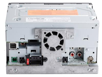

Hi. I have issue with radio.
I have no signal (antenna worked fine with previous pioneer), and step of changing frequency is 105.1fm 105.3fm 105.5fm etc. I can't change this one (like 105.1fm 105.2fm 105.3fm) couse i have no settings in "Settings" menu (and i didn't find this in munual). My screen looks like this:
But i can get no one radio station =( no one... i sow only "No Signal"
Anybody help, i dont know whats wrong....

It really sounds like you don't have an antenna connection somewhere.  I would make sure that the antenna connector is pressed all the way in.  American appradio firmware only allows for odd decimal units.  There is no need for even ones.

Posted Oct 18, 2013 · 12:55 UTC#3
but i need to set up 106.2 FM For Example... how i can fix it??
i dont know. but mb im very stupid?? i tried to connect in red one port near HDMI...
but now im thinking about port in the bottom right... no?
Posted Oct 18, 2013 · 15:07 UTC#4
i fixed it. but last question - how i can change step of frequency?
i need 106.2 fm f.e.

 You need to upgrade with European Firmware.  Search for it on UK pioneer website. That help's me with frequency
