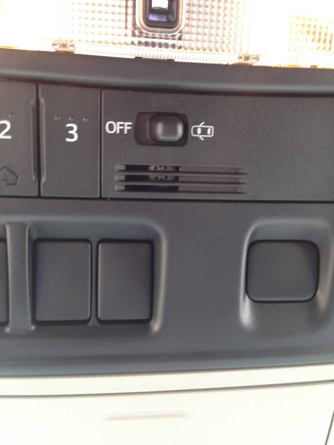

I put mine in the factory spot. Since taking this picture, I added open cell foam above and below the mic to eliminate road noise. Works good with Siri... I never talk on the phone in the car so I have no idea there.117750d1398552746-aftermarket-stereo-img
