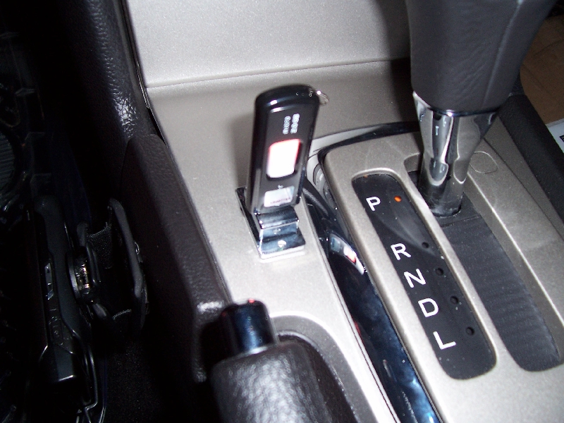

Just installed the Avic-D3 and CD-UB100.
It gets recognized as an external device. It can recognize song names but you have to shorten them to like 12-15 characters or it cuts it off. Not the best functionality, but if you organize your music on the mem stick into folders and know what number folder they were it has no problem playing the songs and searching or skipping.
Just not the best user interface, but It works fine.
I will show pics later. I added a usb coupler in my console so that It looks clean and can just stick mem stick in.

Posted Mar 05, 2007 · 01:00 UTC#4
This is the coupler I ordered from L-Com
http://www.l-com.com/item.aspx?id=8159
They have it in black, and tan.
Then you just need to order a TYPE A to TYPE A USB cable off the iternet. I could not find any the local stores.

Posted Mar 05, 2007 · 01:58 UTC#6
Here it is in a 2006 Zephyr.
Posted Mar 05, 2007 · 04:30 UTC#7
Thats a very nice install.
