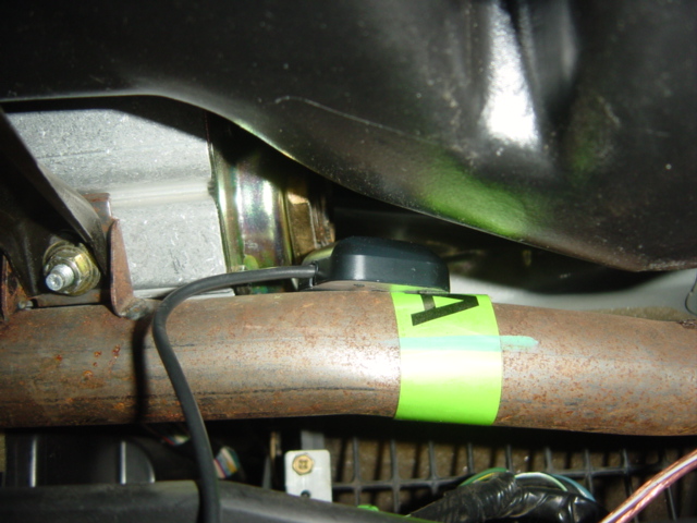

yea ive always thought that was the case before, but yea my antenna currently is shoved behind my glovebox magnetized on the dashboard support. Tracks perfectly, knows exactly where you are at, the sat signal is normal on the setup screen. If you have ever noticed if you are in your garage when you first setup the nav or press reset it defaults you to somewhere in los angeles, but it will find your house thats the signal even going through your house. Ive always had the antenna mounted somewhere within my dash for my cars, 4 runner, civic, audi. Both pioneer and alpine units.

I've had 2 Blaupunkt and one Avic D1 installed in my Passat 05, all with the antenna under the dash. For best reception make sure that you don't have metal above the antenna. Plastic and glass is ok. Also sticking it on a flat metal surface of about 3"by 3" or bigger helps the reception.

I don't see any reason to mount it outside. I have never seen a factory GPS antenna mounted outside. I agree with SuperH. Plastic and glass should not affect GPS accuracy. The factory navigation in trucks like mine is mounted just under the upper dash pad. Just make sure there is no metal blocking it and it should be fine. I just drove 900-miles with my GPS antenna mounted just below the dash pad and it was completely accurate the whole time.

i don't think you need to mount it on the outside at all.. mine is practically buried in my car (it's below the glove compartment and underneath the carpet) and i always get a pretty decent signal and navigation works great
