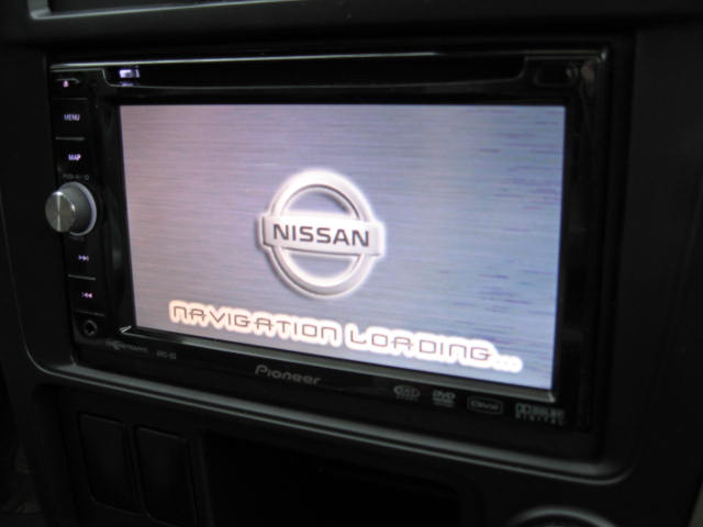

Just installed the D3, bluetooth, XM, and iPOD cord in my '01 Pathfinder. Put a couple of photos here for you to see if you'd like. A few notes:
Bought radio and parts online, got a better deal than in a 4-hour drive from where I live. I also got a really good deal installing the D3 from HappyEar in Watertown NY (I'm not advertising, they just did a good job). They even installed a lockout switch for the bypass without me even asking. Great job.
The Bluetooth (BTB100) works fine. I had to adjust the volume on my phone a bit, but the location (see photo) in the dash is actually pretty good. Passenger won't be able to talk very well, but I'm mainly concerned with my ability to talk. Reception during several phonecalls was perfect and no echo reduction needed. When you install several add-ons from Pioneer, you daisy-chain them together using the BUS-cords and in/out ports on the back. The tech said that it's a very simple design and it now proves itself.
The XM worked flawlessly as well. iPOD cord is really long, but I just coiled it back into the dash behind the glove-box. As soon as my wife plugged her iPOD into the dash, it recognized it instantly and she was able to play podcasts, video (had to turn on "video out" on the iPOD first) and music perfectly. Great built-in seamless integration. Haven't tried my Nano yet, but that's next.
About the background...first--thanks to those who've posted backgrounds on the Custom Background forum. Really appreciate it! I had a bit of trouble getting the D3 to recognize the disk initially, but after reading about 10 threads about doing it, I found that I didn't "close the disk" for any CD-ROM device to read. Used plain Roxio CD Creator and once I closed the disk...perfect integration. By the way, if you're looking for info on putting in a new background, use tjdehya's post on Mon Aug 14 in the thread announcing how to make backgrounds...very helpful and right on target for the D3 although it wasn't out when he posted his reply.
Okay, that's all. Thanks for all the help. Great forum and great advice.

I was worried about the installation angle as well...thought about the Eclipse system or a more expensive pioneer a million times before going for the new D3. In the end, it worked out just fine. Not only can I see just fine, but the angle keeps the screen out of sight from others outside the vehicle (works well when my wife wants to watch her iPOD video and we don't want to get pulled over), and since it's LCD...the viewing angle instructions are listed below from the Instruction Manual:
Due to its construction, the view angle of the LCD
screen is limited. The viewing angle (vertical and
horizontal) can be increased, however, by using
Brightness to adjust the black density of the
video. When using for the first time, adjust the
black density in accordance with the viewing
angle (vertical and horizontal) to adjust for clear
viewing. Dimmer can also be used to adjust the
brightness of the LCD screen itself to suit your
personal preference.
On a personal note, I have found most LCD screens publish a viewing angle between 150-178 degrees, which means that the small screen is visible in the right light (see paragraph above) easily from the side. I had no issues with daylight hampering my vision of the directions or video, and at night you can select a dimmer view if you want, or you can even black out the screen as well. I haven't played with it that much, but in the little time I've had it installed...the angle either vertical or horizontal isn't that big of a deal. In the installation manual, however, they indicate that you can install the unit up to 10 degrees horizontally (must correct by 5 degrees using software if you install it this way, page 20 of the attached manual) and up to 30 degrees vertically. Might be a good solution for your Pathfinder install. Hope this helps.
