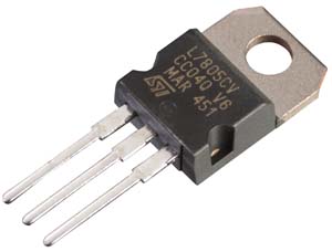

i had the same problem in my car (07 mustang gt) i dont know if you are in canada or not but at the source (formerly radio shack) you can get a voltage regulator for $3.49 you put the input from your deck remote wire on one side, ground on the middle pin or even the front and the lead to your amp on the other side.
works great for me.
