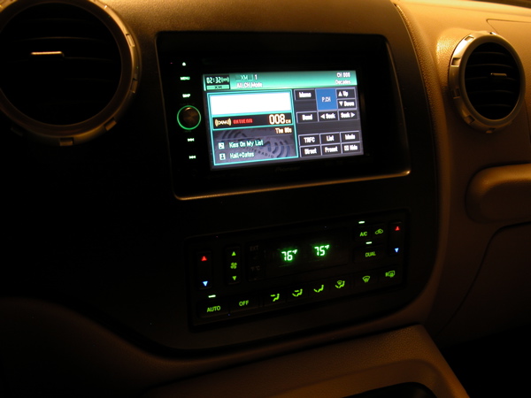

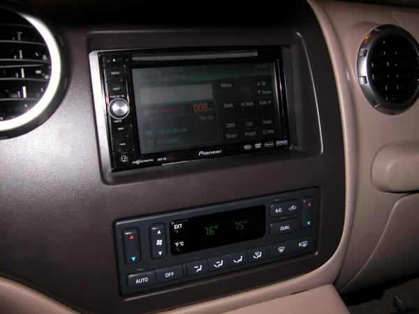

I have a D3 in my 2004 Expeditiion... it looks and works great. Did the bypass, and it works perfectly.
Here's some pics.
Without flash
With flash
Posted Mar 17, 2007 · 14:07 UTC#13
That install looks great! After I rechecked everything, I had a loose connection. Once all the wires were connected solidly, the bypass works fine.
