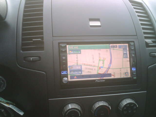

Posted Apr 05, 2007 · 01:40 UTC#3
Here's a pic. I don't know how to show more then one in a post. It's all done. Didn't take too long. If anyone does this is a 2.5s VSS is behind instrument cluster.
