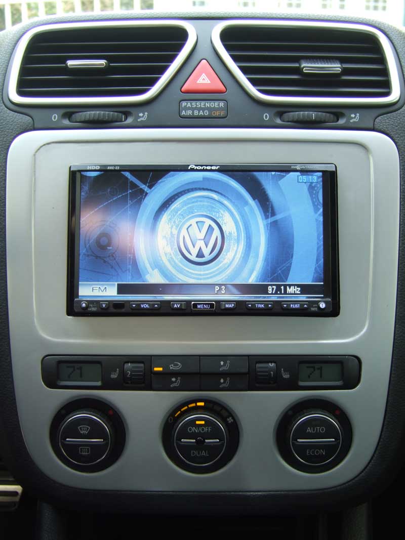

I had an N3 in my old car and I just bought a 2007 VW EOS and installed the Z-2 w/ IPOD, Bluetooth, XM Nav and SIRIUS. Found out that the "Technology Package" option on my car INCLUDED a video camera with the rear backup warning beeper, so that was an easy plug-in.
Pictures to come l8r today!!!
First of all wow, sooo much faster and love the voice stuff (when it works). My installer was able to utilize the Volume and mute buttons on my steering wheel. I was surprised that you STILL cannot load MP3s on the HD. :( I was also bummed that the screen still does not tilt forward only backwards.
Problem #1: Bluetooth is STILL very echoey. Do you think I should try this update CD?? I cannot at the moment try the volume down paring, because my installer changed the password and I'm guessing I need to do a level 3 reset to get that working.
Problem #2: XM Nav traffic shows green and red lines with accident icons, but ALL of the traffic buttons under information are STILL greyed out. Any Ideas?
Problem #3 the slope indicator is not functioning.
