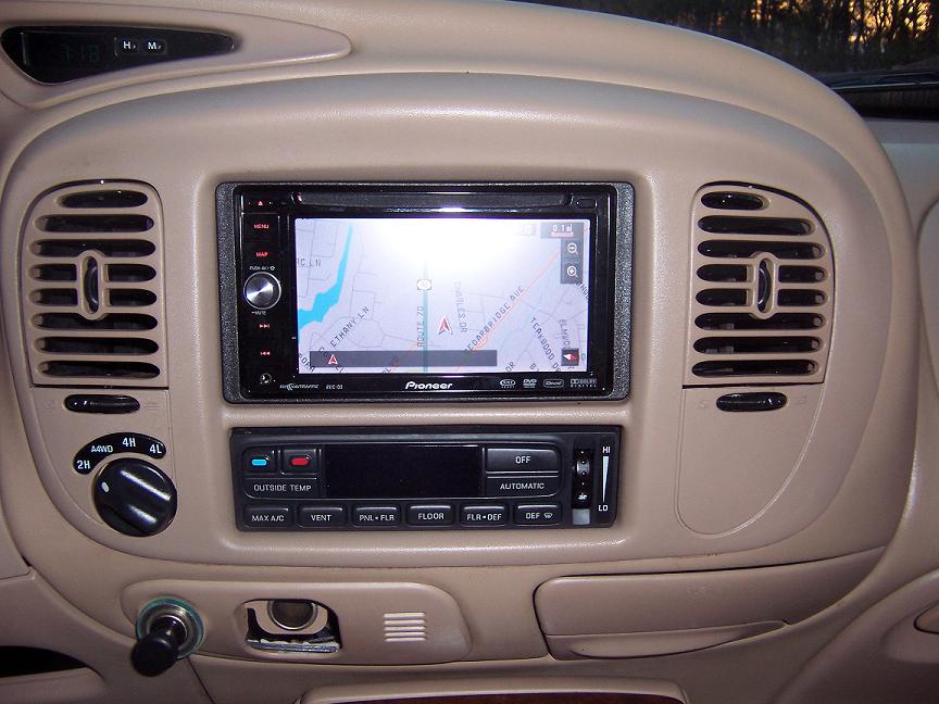

Here's a 98 navi I did the other day. Used a 99-5805 and quite a bit of cutting. By the way none of that cutting involved the air ducts in any way. I also had to completely remove most of the dash because the factory radio would not come out. After removing 57 bolts and the stock radio. I realized that doing that made it 100x easier to make the needed cuts to the radio opening and the rear area. All in all not bad just time consuming. Total cost for this guy for install was 461 plus tax.
