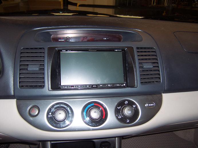

Posted Apr 29, 2007 · 03:42 UTC#7
95-8203 is what I've used in the past. Works fine for me here's the final outcome.
Posted Apr 29, 2007 · 03:45 UTC#8
Dude, that reply was so fast it's unreal! That looks great - what brand is the kit? I want to order one!
Posted Apr 29, 2007 · 03:48 UTC#9
It's metra sorry, If you don't mind the extra cost, most Circuit City's stock that kit.

Posted Apr 29, 2007 · 03:55 UTC#11
Not a problem. When you get the kit though the lower lip on it is fairly flimsy. What I normally do to help reinforce it is take some double sided tape and stick it on the bottom of the kit so that it stick that to the dash piece. You'll see what I mean once you actually get the kit.
Posted Apr 29, 2007 · 19:57 UTC#12
Bought the kit this morning & installed it. Looks waaaaay better now, plus the OEM mounts are more secure than the plastic ones in the AI kit...
I didn't have any issue with the bottom being 'flimsy'... The top of the bezel still sits a little proud of the dash, so when I install the camera, I will deepen the grooves a little to give a hair more adjustment there so that it will sit perfectly flush.
