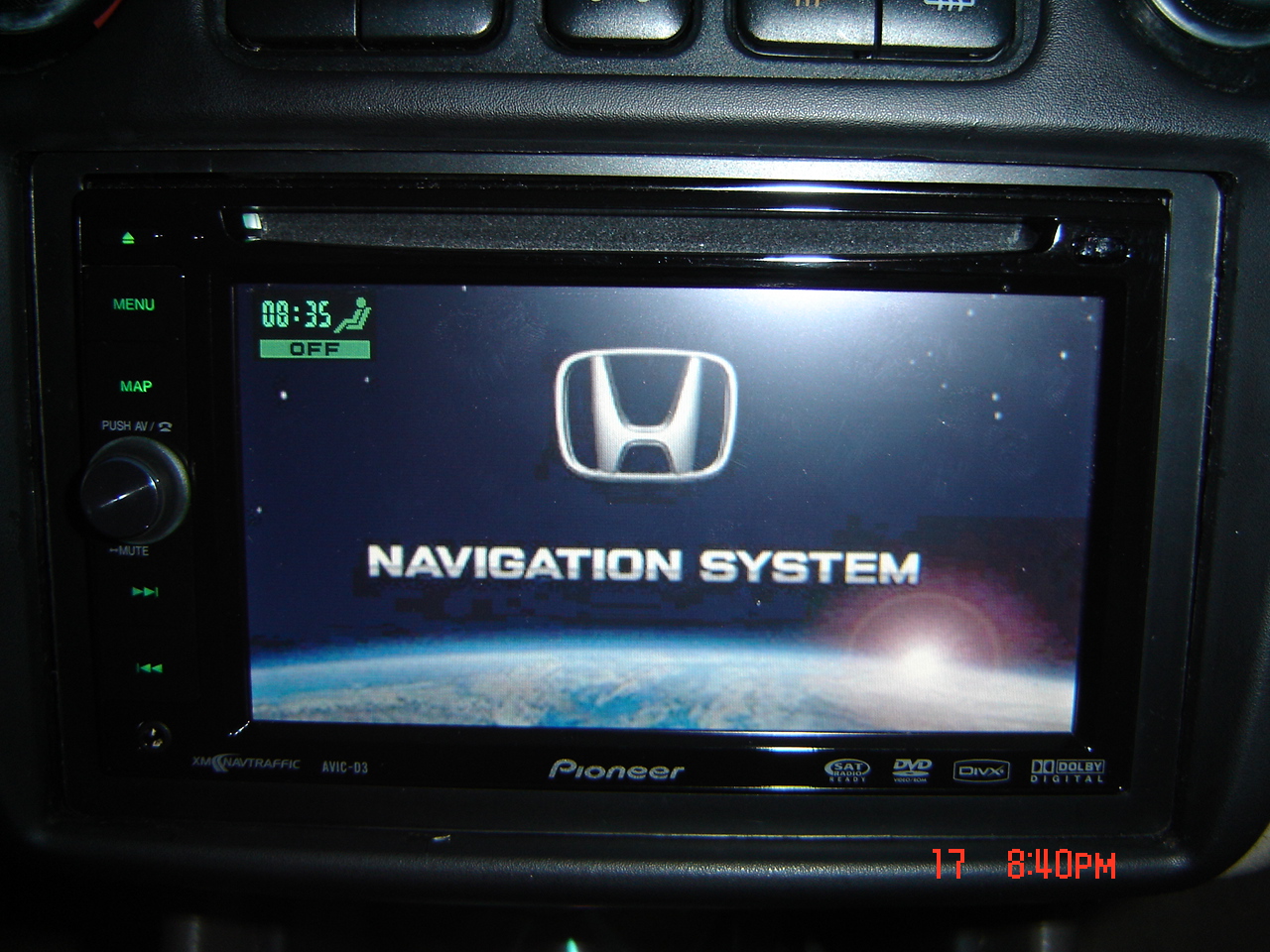

Posted Jun 18, 2007 · 01:54 UTC#12
it worked fine for me ;)
:D
looks more then facotry
avic d3 with bypass
