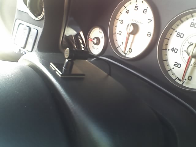

i ended up making a little mount holdes the mic on top of the steering column.
pretty good clarity and semi-hidden...
i would have preferred to have done what you did with the flush mount - that that covers the noise cancelling portion of the barrell (probably what is creating ur echo).
Posted Sep 08, 2007 · 21:20 UTC#18
do u have a pic of what u did?
Posted Sep 08, 2007 · 21:55 UTC#19
sorry for the bad pics (cell phone) but i dont have my camera with me so...
i made it out of part of the Schoshe dash kit (lol) and the stock mic clip
