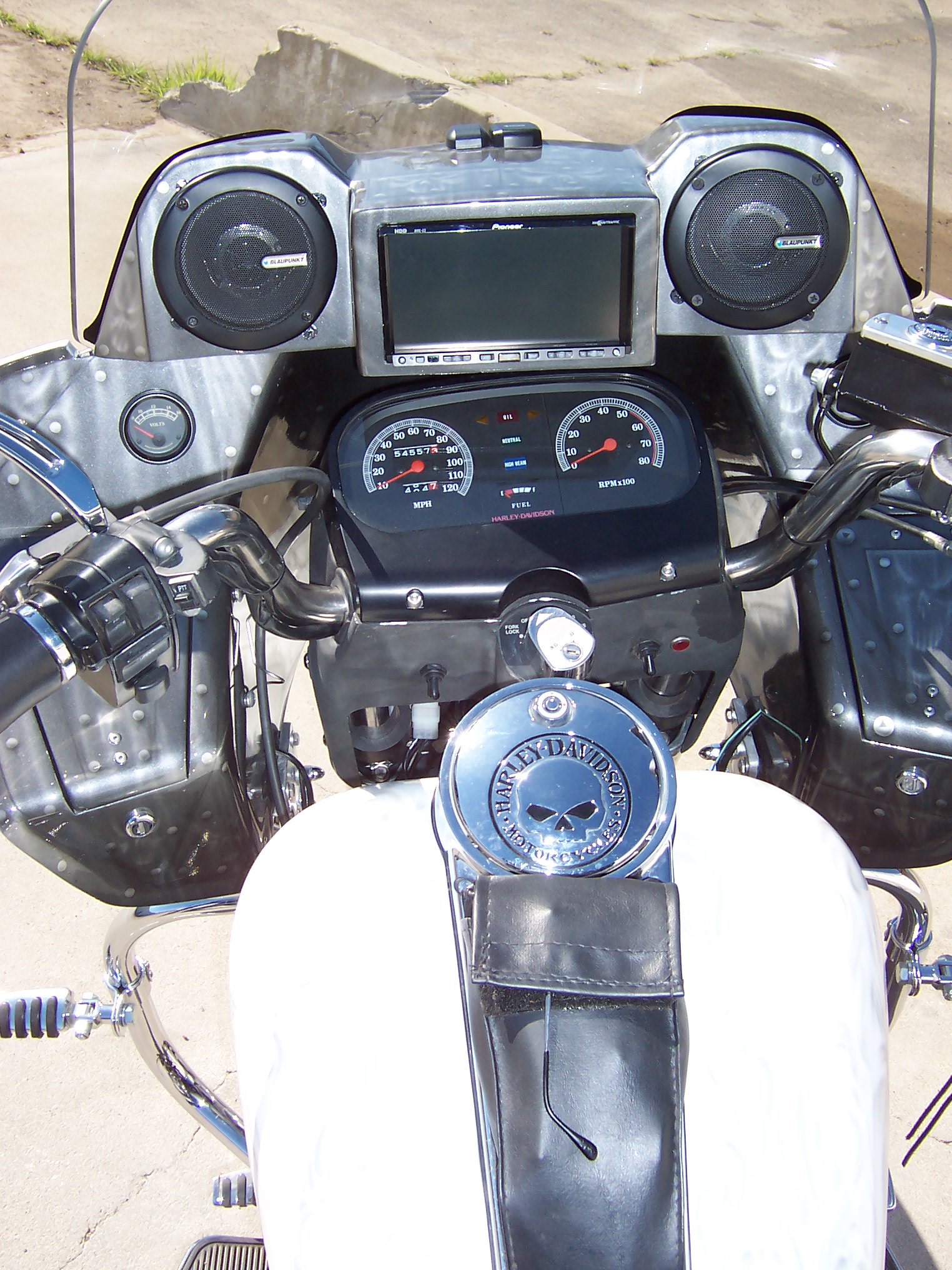

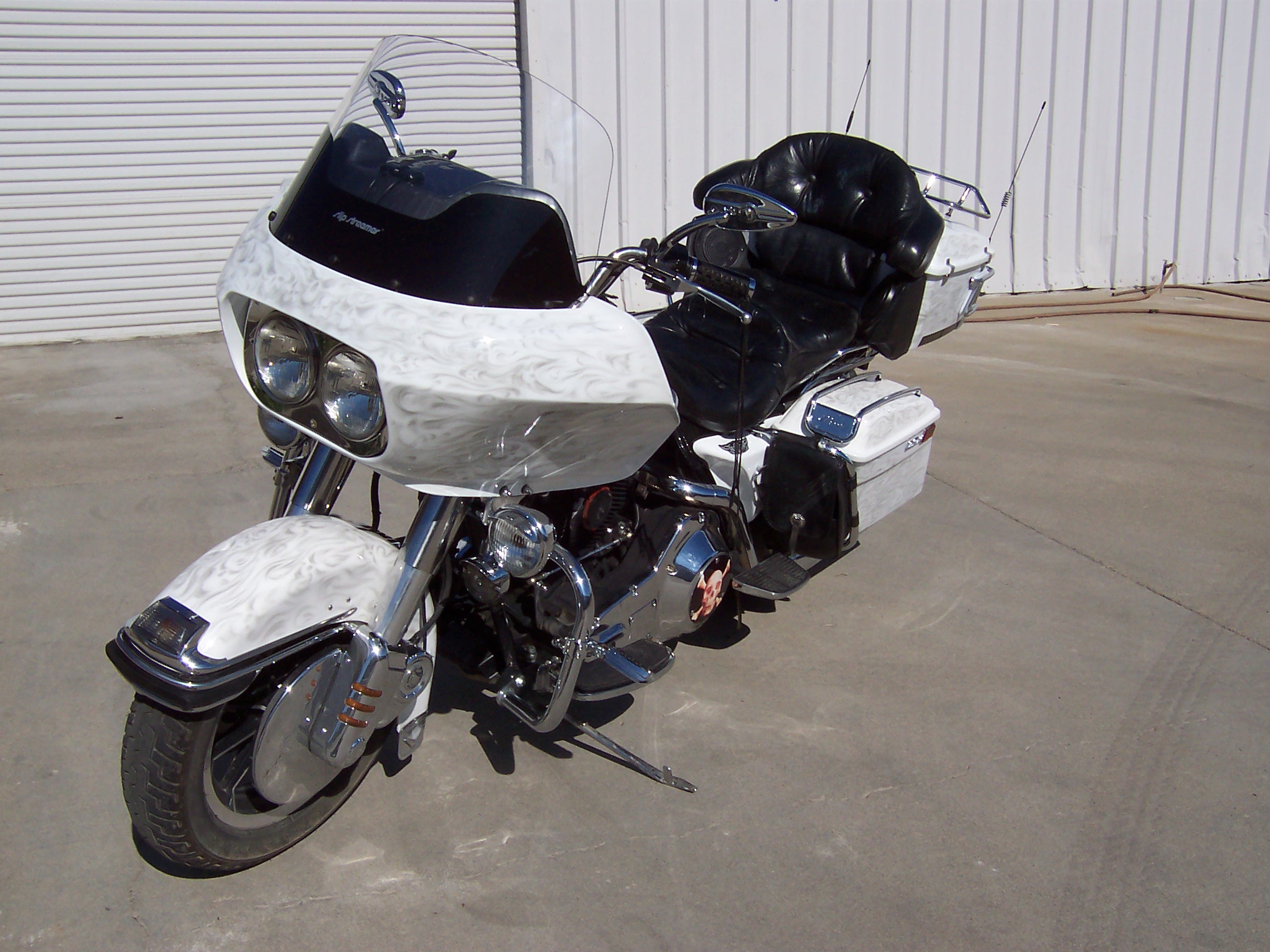

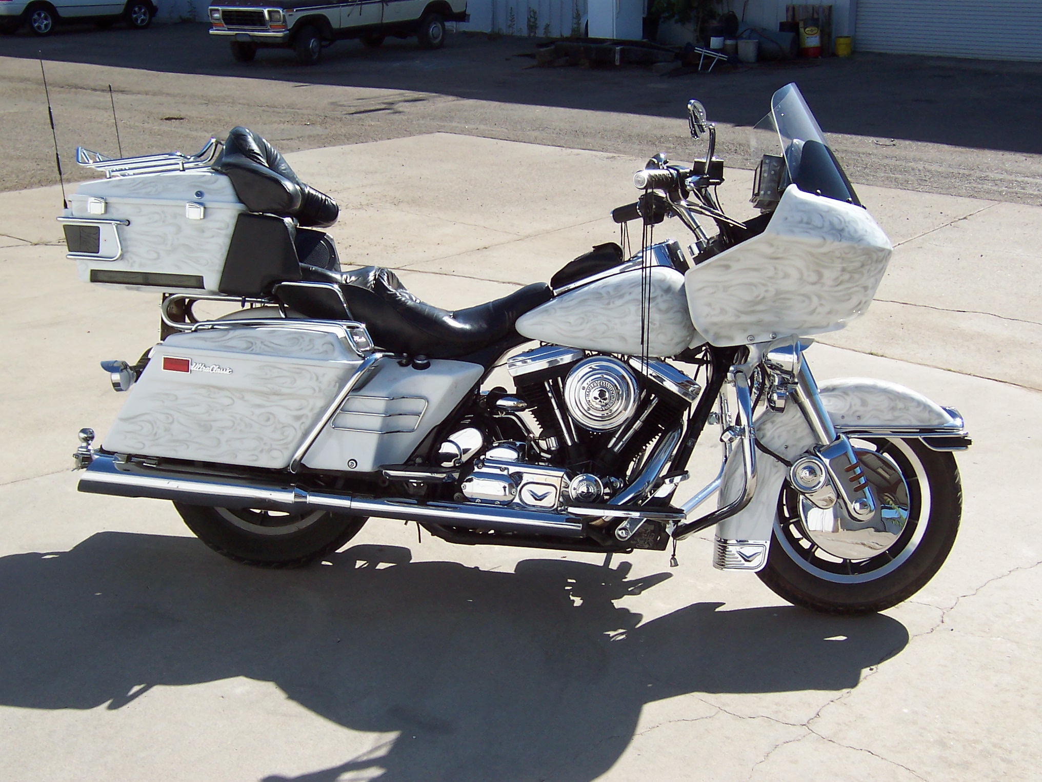

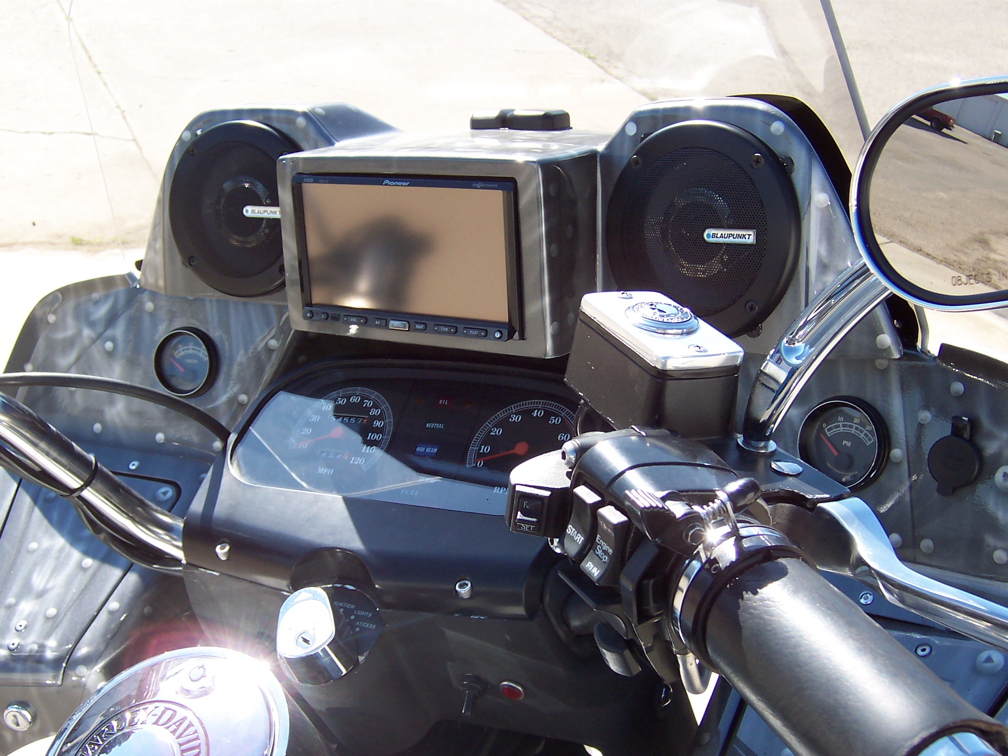

Here is a couple of shots Of the bike for ya'all
Posted Jun 11, 2007 · 13:11 UTC#10
Nice bike, im definitely diggin the paint job. I'd be kinda scared doing any over night trips with that avic though..... looks like a straight up "HEY STEAL ME" sign. Install looks good though man. :D

Posted Jun 11, 2007 · 17:57 UTC#13
That looks great! But aren't you worried about rain?

looks good, but i dont know about having those magnetic antennas so close to a hard drive
Posted Jun 12, 2007 · 03:56 UTC#16
I think it's fine. The magnets are at least 3 inches away. And the magnetic
media is inside a few shielded metal enclosures between the platters and the
antennas. Honestly I wouldn't worry about it. We have tried doing tests to
delete stuff off floppy disks and hard drives with magnets and it takes more
thank you would think to hurt a hard drive. I think he is ok there.

I see 2 GPS antannaes!
Posted Jun 12, 2007 · 11:25 UTC#18
I think the one on the left is the GPS antenna and the one on the right is Sat Radio, but yes there are 2 antennas.
